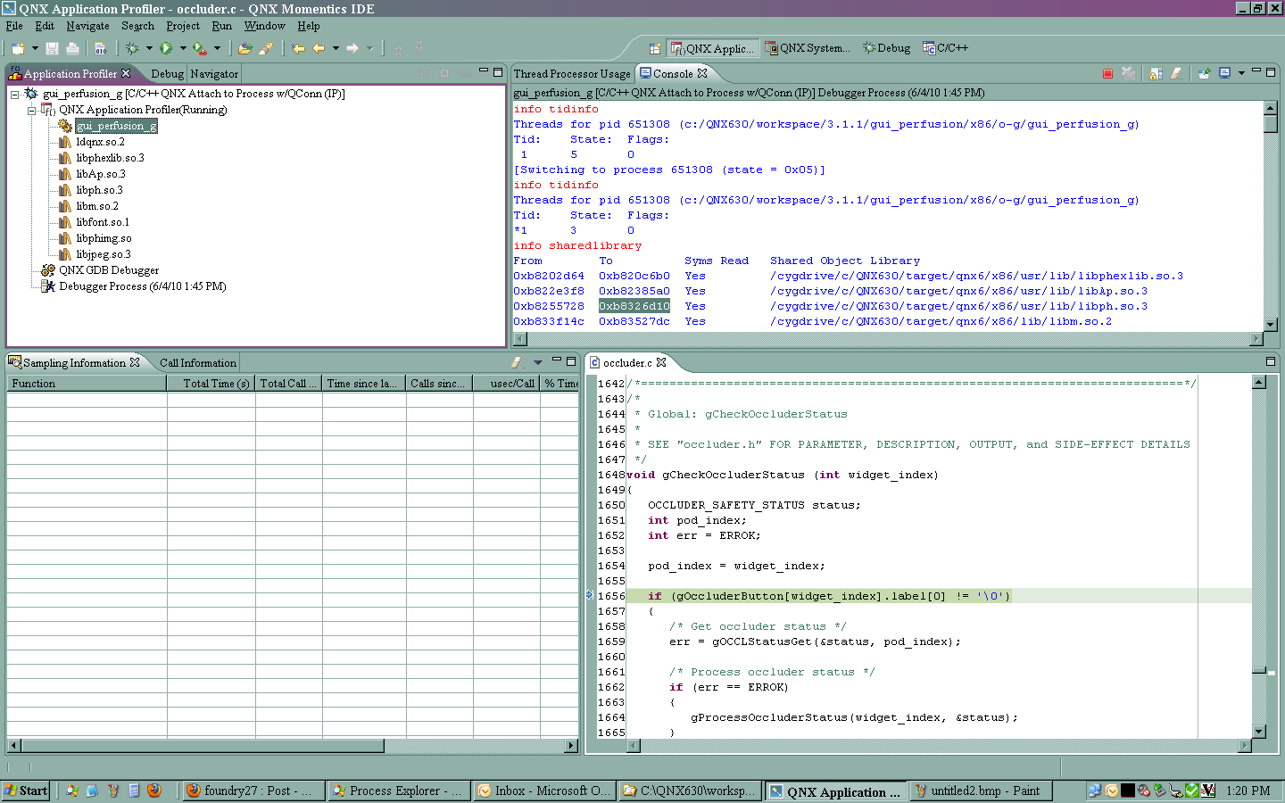

I'm attempting to run the application profiler on a legacy project that is quite large. I followed the instructions
provided in the help file and all seems simple enough but I'm encountering a problem.
I can build and debug the app without issues. The app profiler will run while debugging on the target device, but it
does not recognize any of the functions in the project and hence does not list them under the "Sampling Information" tab
in the App Profiler Prescriptive. It will recognize one or two functions from the shared libraries but that's it.
I'm using QNX Momentics Development Suite 6.3 which uses IDE 3.0.0.
My only theory about the problem is that I think the app builder does not know the location of the source files. I
tried the app builder on a similar but much smaller project and it worked. The difference is that the non-working
project has it's source files in a "src" folder off of the workspace root while the working one has the source files on
the root (in C/C++ Project View). This path is listed in the "Extra Source Paths" compiler options. I also included the
"src" folder in the "Additional Source Locations" under the Debug menu "source" tab. Neither worked.
