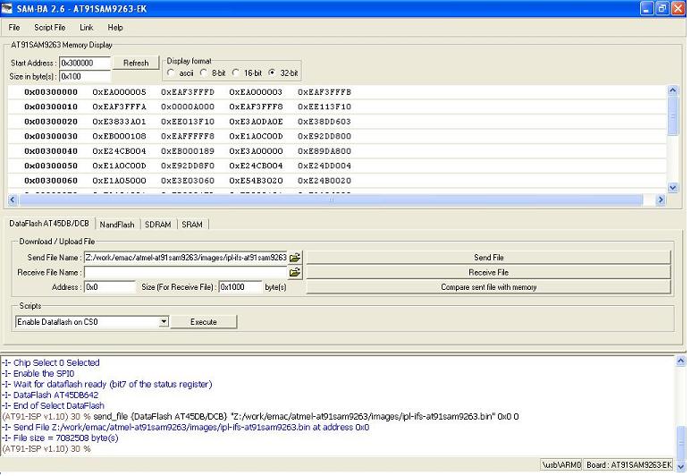

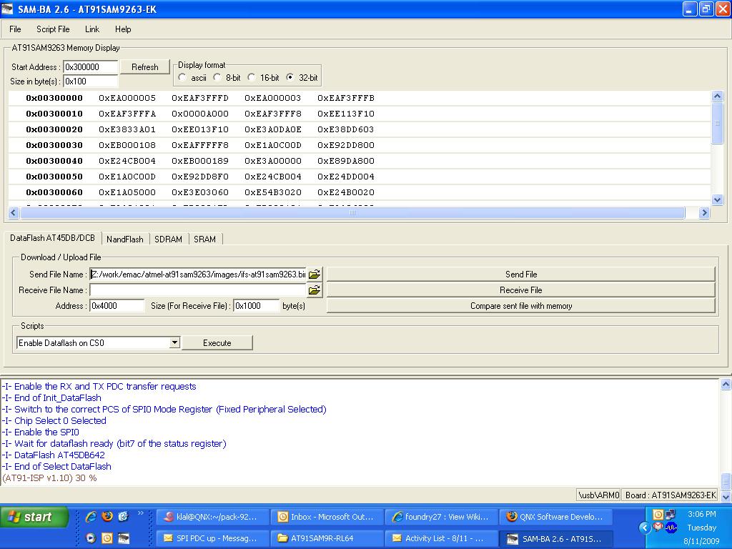

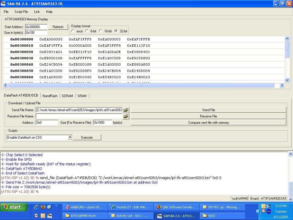

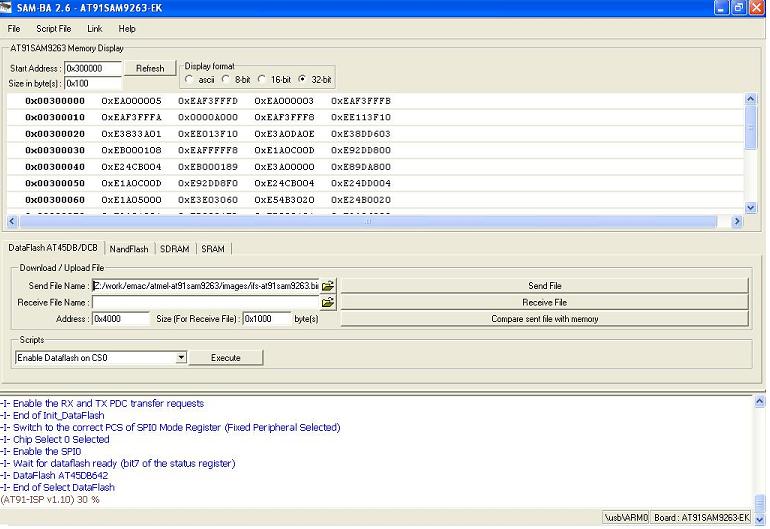

Loading the IFS image using SAM-BA#
  • Plug the Atmel Data-Flash card into the socket A.
  • Select the Data-Flash AT45DB/DCB tab in SAM-BA Application. Execute the Enable Data-flash on CS0 script.
  • Select the ipl-ifs-at91sam9263.bin file to be sent to the target, and then press Send File. Depending on the size of your file, it will take a few seconds up to a minute.
Nto640AtmelAt91sam9263EKEVBTrunkReleasenotes/ipl-ifs-image-load1.JPG
Press the reset button, now on your terminal you will see output as follows:

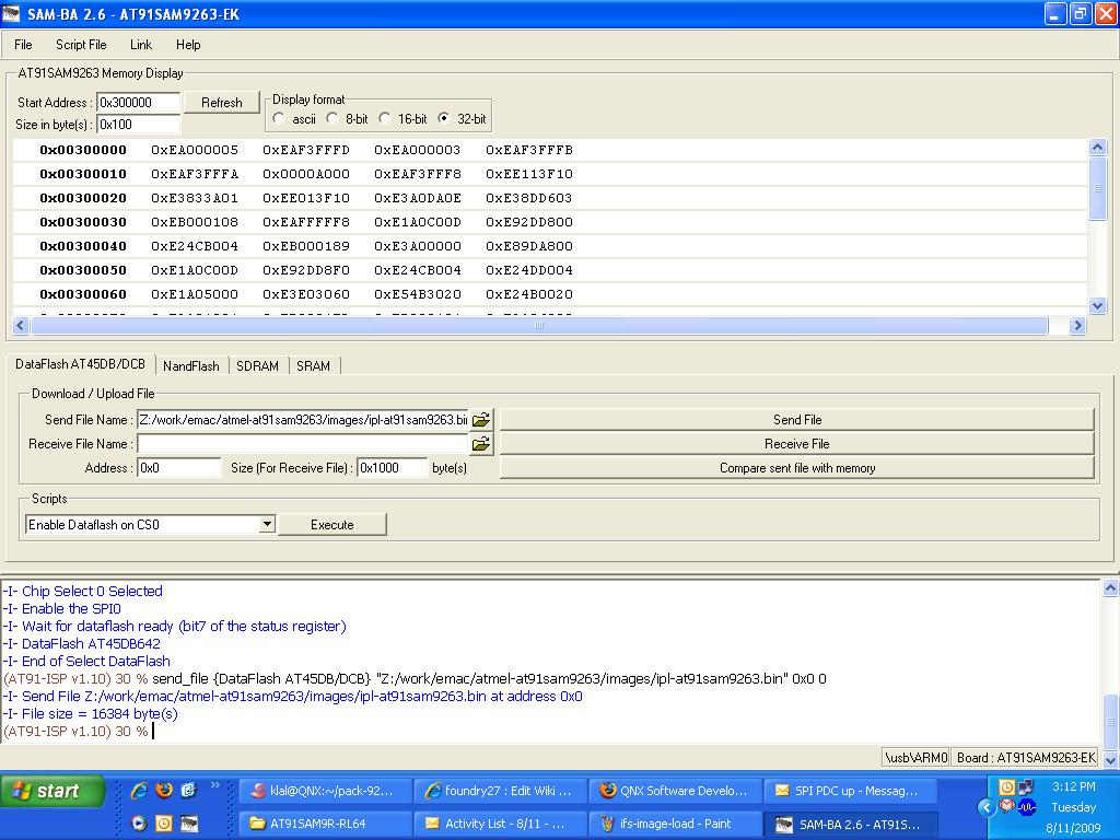

Step 3B: Reprogram the IPL.#
In case if Board is new or IPL gets corrupted, We can reprogram IPL using SAM-BA application.
  • Select the Data-Flash AT45DB/DCB tab in SAM-BA application window, . Execute the Enable Data-flash on CS0 script.
  • Select the ipl-at91sam9263.bin file to be sent to the target, and then press Send File. It will take a few seconds up to a minute.
  • Snapshot is as follows:
Nto640AtmelAt91sam9263EKEVBTrunkReleasenotes/ipl-image-load1.JPG
