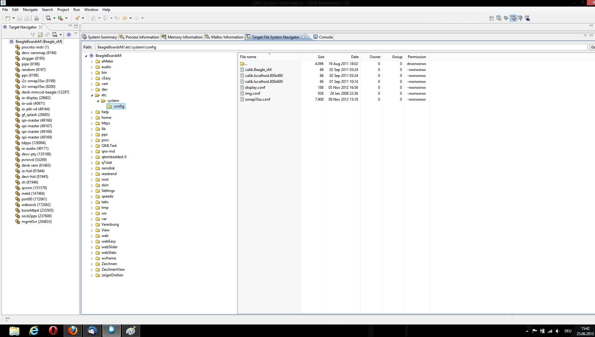

Hi Dennis
I checked the processes on the BBxM and the folder /etc, but there is no "ttys" named-file and "tinit" is also not
running.
In the pictures you can seee the processes running on BBxM after start and the fileSystem structure.
Hope this helps
Attachment: Image SystemInformationPerspective.jpg 513.19 KB
Re: Qt 4.7 on QNX 6.5.0 SDP1 using Rs232 interface on Beagleboard XM
And the FileSystem
Attachment: Image FileSystem.jpg 279.24 KB
