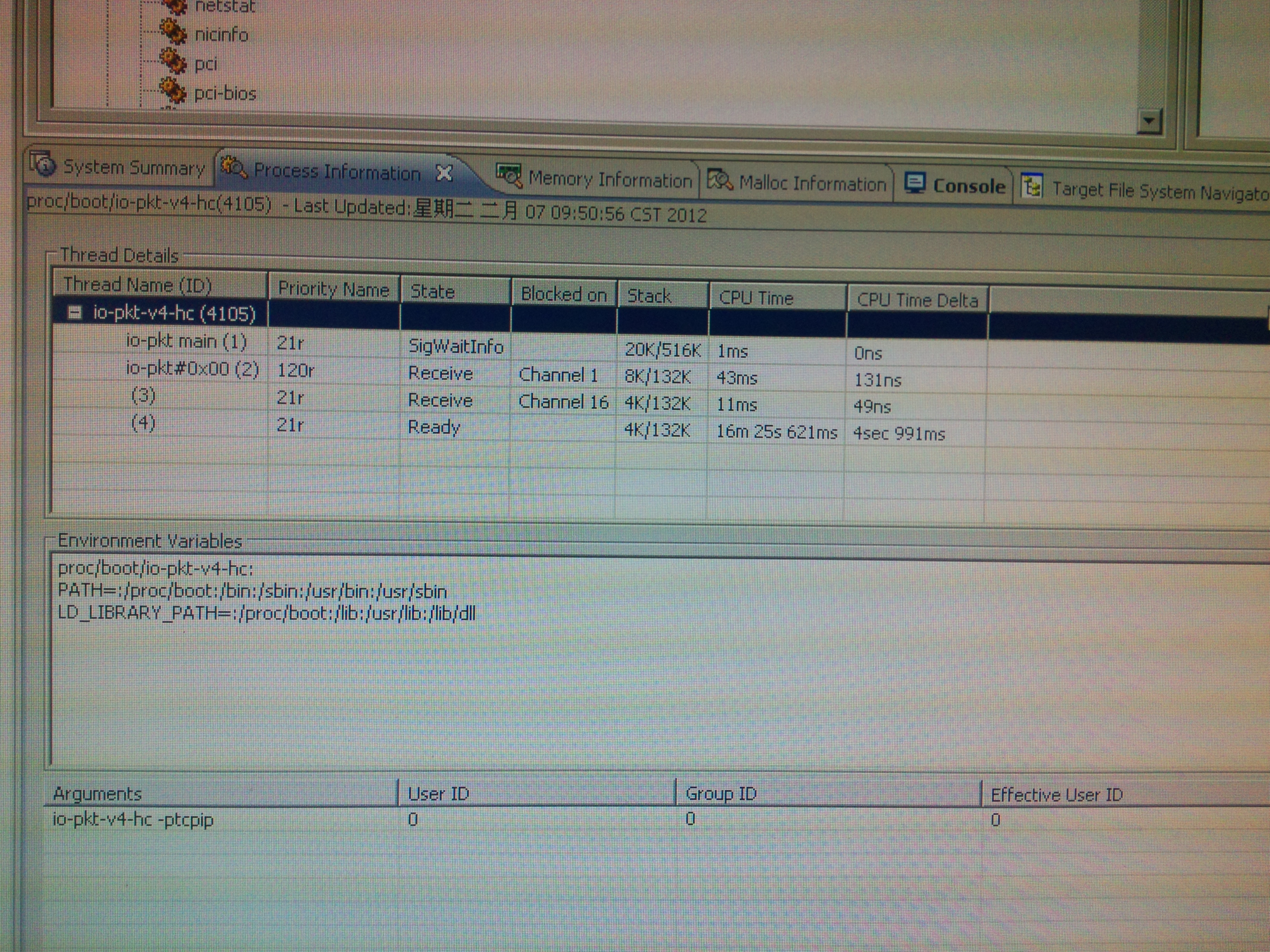

Re: io-pkt mount double rtl839 is failure.
I try mount two 8139 like this:
1.  io-pkt-v4-hc -ptcpip
2.  mount -Tio-pkt -opci=0,vid=0x10ec,did=0x8139 devn-rtl.so
3.  ifconfig en0 192.168.3.60
4.  qconn
5.  mount -Tio-pkt -opci=1,vid=0x10ec,did=0x8139 devn-rtl.so
now the shell is almost hang. when i type keyboard, i get severl input on screen shell.
I connect target from development host by qconn.
I can get io-pkt process information, the pic attached.
I can ping target .
From target filesystem navigation windows ,I can see en0 and en1 device in /dev/io-net/ directionary.
anybody can tell me the reason.
Attachment: Image IMG_20120207_094046.jpg 4.74 MB
>4.  qconn
>screen shell.
>I can ping target .
>_______________________________________________
>Networking Drivers
>http://community.qnx.com/sf/go/post91367
