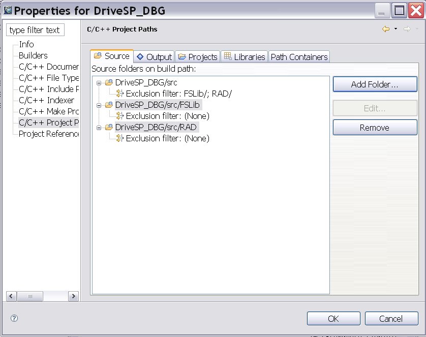

2) When trying to debug, I get the message "No source file named
   my_filename.cpp." And I am wondering why this happens. I could debug
  before, but when I added new files to the project, these could not be found.
  Thus, I considered creating a new project to be a good idea (Now I know, it
  was not...).
  The project is build outside the Momentics IDE. I am only using the IDE for debugging, by using a C/C++ Stnadard Make
Project, where I added the required files as 'links' to folders in the file system.
I added the screenshots of my project structure and the source path settings to this post.
 I am able to set breakpoints within the files of the "src" folder, but not within the files of its subfolders. Do you
have any ideas why this source file cannot be found?
I would be grateful for any suggestions how to get this working (again)!

Re: Debugger Error: "Unable to find dynamic linker breakpoint function"
Here is the other screenshot...
Attachment: Image Project_Paths.jpg 74.41 KB
Hello Michael,
What is the gdb version you are using? Could you download the latest gdb-6.7 (update 4) and try again?
http://community.qnx.com/sf/frs/do/listReleases/projects.toolchain/frs.gdb
For the 2) could you type
show dir
in your IDE debugger log view?
It should display all directories where gdb is searching for source files. Your subdirectories should be there to.
Thank you,
Aleksandar
