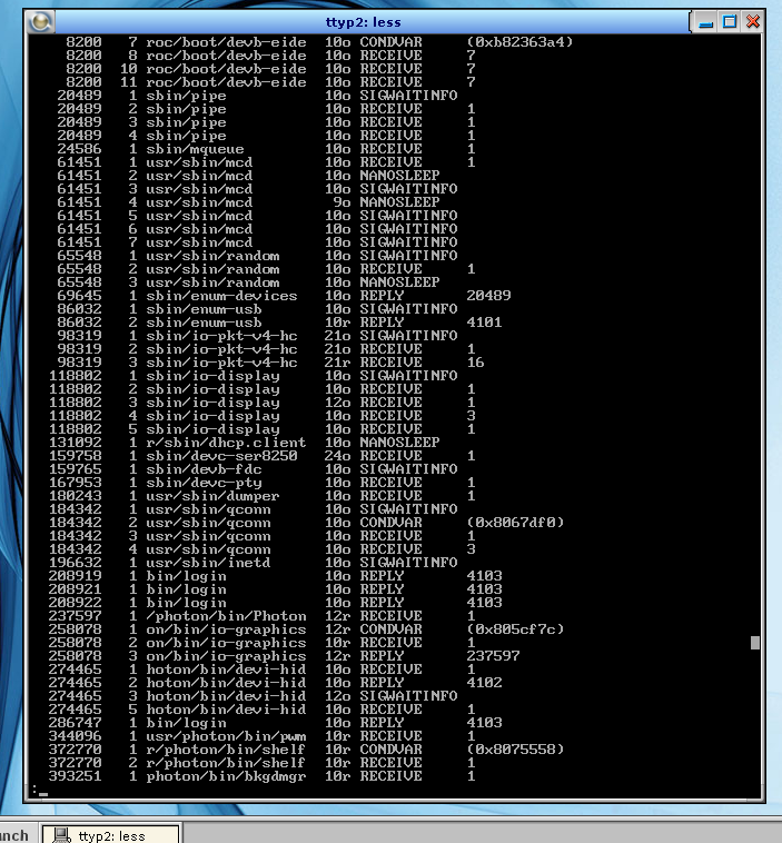

> qnx_qconn.png: Shows QNX 6.41 as VM that qconn is running
> momentics_qnxrtos_cpu_details.png: Shows that the QNX 6.41 VM uses a x86 architecture.

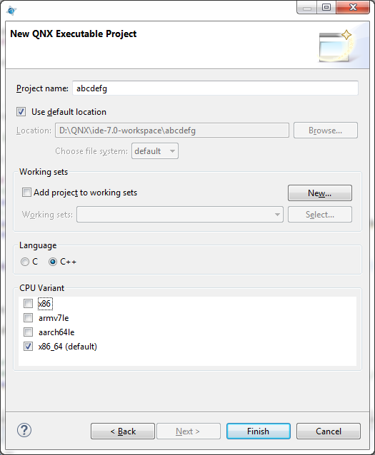

> project_creation.png: Shows creation as C++ Project for x86 architecture. ("File" -> "New" -> "QNX Project" -> "C/C++"
-> "QNX Executable")

Looking at the images that you have captured, you are attempting to run an SDP 7,0 x86 32 bit application on a QNX 6.4.1
target.
You need to setup the x86_64 SDP 7.0 VMware image that you downloaded from the QNX Software Center and change your
project settings to build for x86_64.
