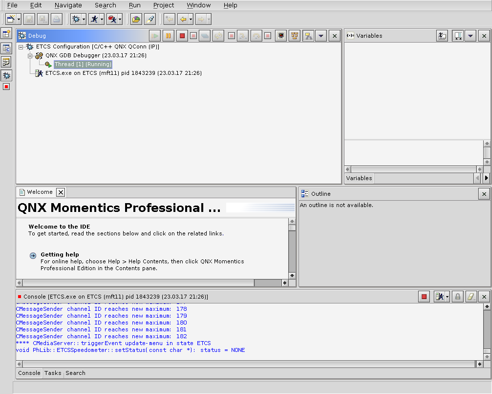

the (a)pplication (u)nder (t)est located on the target device starts remote from the C/C++ QNX QConn (IP) configuration
inside the QNX Momentics IDE located on the virtual machine on the host. At this point the aut is still running, one

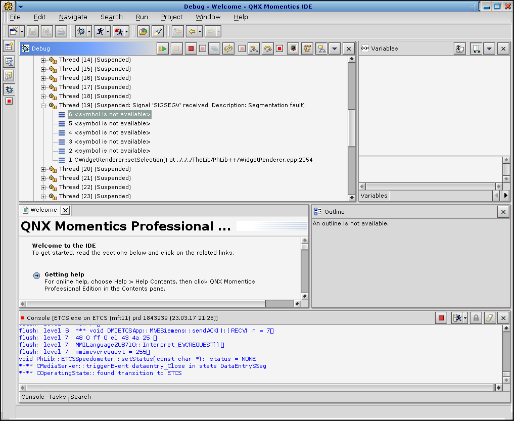

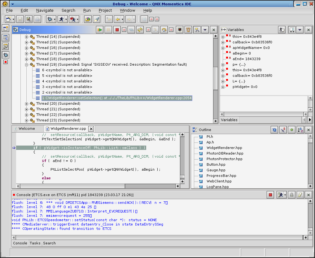

thread only (snap1.bmp). then a test script starts (crash.sh). the script runs a loop, open a data input dialog, type
input data, close input dialog, send data over bus (MVB). here is the point the aut crashs. the loop runs 33 times. with
 Thread [19] (Suspended: Signal 'SEGSEGV received. Description: Segmentation fault). the stack to observe is 1
CWidgetRenderer::setSelection() at ../../../TheLibPhLib++/WidgetRenderer.cpp:2054. the host system is QNX qnx630mf 6.3.0

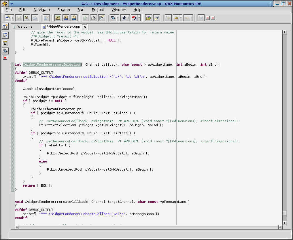

@thaupt: snap4.bmp is the function souce code
Attachment: Bitmap snap4.bmp 2.42 MB
