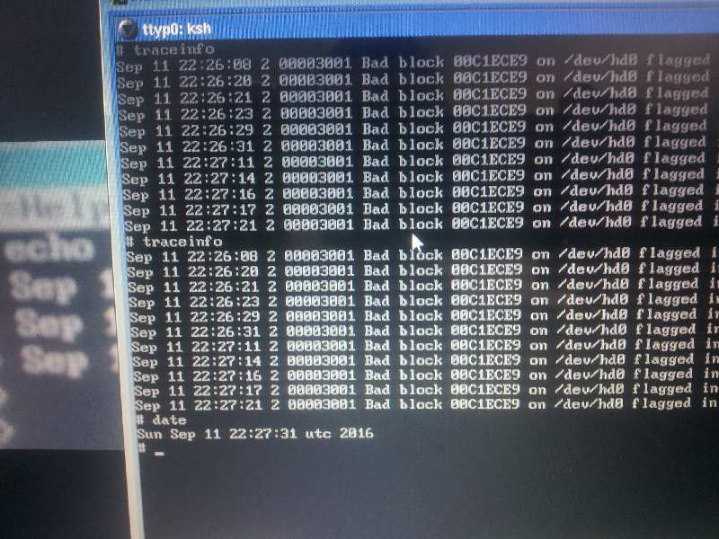

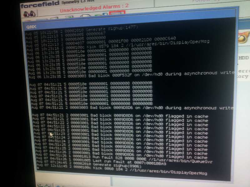

Hi Andy,
> 1) I see that dcheck has a 'disable drive error correction' options. Is this a suitable candidate ?
It seems that this has sense for Fsys.ata only (old driver) to disable ECC check.
> 2) Is there an ioctl() that will do the cache invalidation?
Did you try sync utility to flush caches? Did it help?
> 3) Is all this caused by Fsys.Fsys.atapi caching I/O Errors when they shouldn't be cached.? If so can that behavior be
stopped?
Disk cache is driven by Fsys, not the disk driver. I can't know how to disable caching in this particular case.
> We have the source and the error happens in one place. If we could invalidate the cache , retry and move on (or not
if its a real error) . This would help production and allow us time to get the best replacement.
I understand this. Unfortunately, I can't debug the issue without the ability to reproduce it. And even more the
debugging may take quite a few time.
