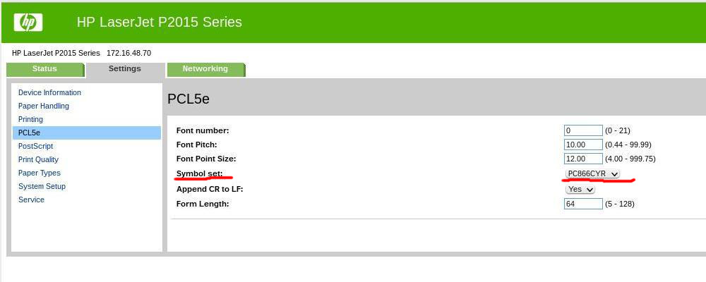

It seems that your printcap file is correct. I have HP LaserJet P2015 printer that should be similar yours I guess.
Please check Settings / PCL5e / Symbol set option. You have to set this option to PC866CYR to print plain text in
Cyrillic IBM866 encoding (default Russian encoding for QNX4 console). Please see attached image. If this won't work then
send me example of file that you're printing.

Thank you very much for your help. May I help you? In addition, your picture is Windows printer driver software? How can
I set up this option under QNX4?

Re: 回复: The use of LPD QNX4 under way, why can't print Russian? (print HP2055dn).
06/02/2015 10:19 AM
post113906
非常感谢您的帮助,请问您的意思是我打印机设置有问题吗?另外,您的图片是windows下的打印机驱动软件吗?我在QNX4下如何能设置
这个选项?
06/02/2015 10:20 AM
post113907
Re: The use of LPD QNX4 under way, why can't print Russian? (print HP2055dn).
06/02/2015 10:46 AM
post113909
I’ve configured my printer via web interface. You can use Windows to setup printer. After this you can print under QNX.
06/02/2015 10:49 AM
post113910
Thank you very much. I think your method should be right. I'll go to the company to test tomorrow..
06/03/2015 4:40 AM
post113916
Oleg:
Thank you for your help.! Today I according to your method test, print newline incorrect has been resolved. But still
cannot print Russian, accessory is the test file, hope you can help me to test you, dear bitter.
06/04/2015 6:00 AM
post113922
Hello!
Please attach a screenshot with your settings of symbol set and a text file that you print.
3 июня 2015 г., в 11:29:38, 眼镜 <community-noreply@qnx.com> написал:
06/05/2015 5:41 AM
post113926
Oleg:
Under your help,The problem has been solved.!thank you very much@_@
Glad to meet you.
I wish you a successful job
wenwei.
