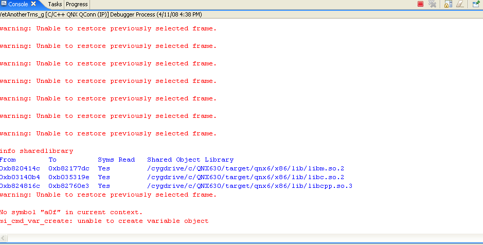

When i am trying to debug i get the following errors while debugging on QNX,
"No symbol "a0f" in current context.
mi_cmd_var_create: unable to create variable object".
i also get this warning: "warning: Unable to restore previously selected frame."
a0f is a variable that is not in this project. I clean build the project each time.
The application has single digit values are assigned to local float variables.
I see that while single stepping on the debugger these variables get NAN values.
Why I am getting these errors and warnings?
How can i eliminate these errors?
Thanks for your help.

You should post this into the IDE forum.
( include the output of
qconfig
from wtihin a DOS-cmd-shell, when doing so )
That forum is here:
http://community.qnx.com/sf/discussion/do/listTopics/projects.ide/discussion.ide/
my _guess_ is  first to update Your
underlaying QNX630 to service pack 3 level and (or) use an other gdb (gdb-6.7-u7) available here:
http://community.qnx.com/sf/frs/do/viewSummary/projects.toolchain/frs
Hope this helps.
