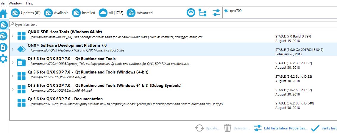

We installed the QT through QNX software center (Fig QT_QNX).
We are using SDP 7.0 and QNX Momentics IDE (Version: 7.0.4.v201905030143) in our design. During compilation, we are

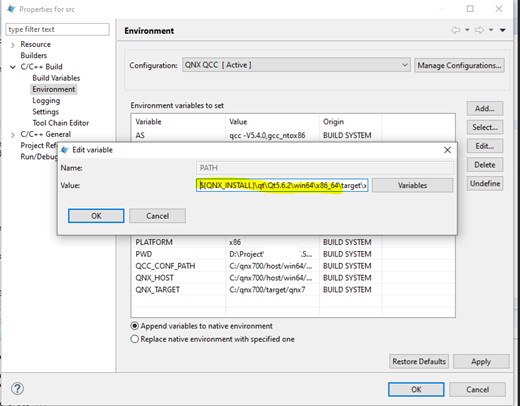

In the “Environment tab” under project settings, we found that the toolchain path is prepended before the path we
created with .bat file. We manually modified the PATH variable in IDE, by declaring the of QT PATH (\qt\Qt5.6.2\win64\
x86_64\target\x86\bin) before the toolchain path. And the compilation was successful. (fig 2)
Could you please let us know, how we can solve the issue? Also, is there any method to prepend the QT path variable
before toolchain path from the .bat file?
