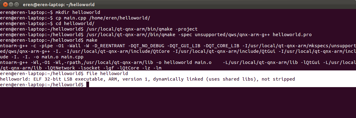

There is an error in my Target Setup step. I complied qt hellowrold project. You can look image5.png for complie steps

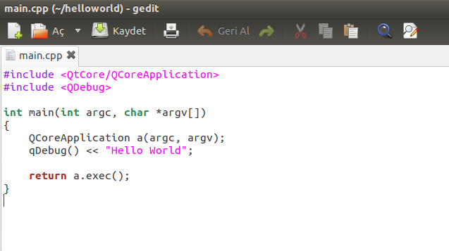

also if you wanna  look qthelloworld application source you can look image12.png

I assume you are building for Qt4...
image5.png says "ARM version 1".  It is unclear to me whether you are building for "armle-v7".  Only libraries for armle
-v7 are available - unless you build them yourself.  BUT you should run 'v7' on beagle.
To be sure what libraries need to be included, run this against the program you built.
  # ntoarmv7-objdump -x helloworld | grep NEEDED
You should see output indicating which shared libraries it is linked to.

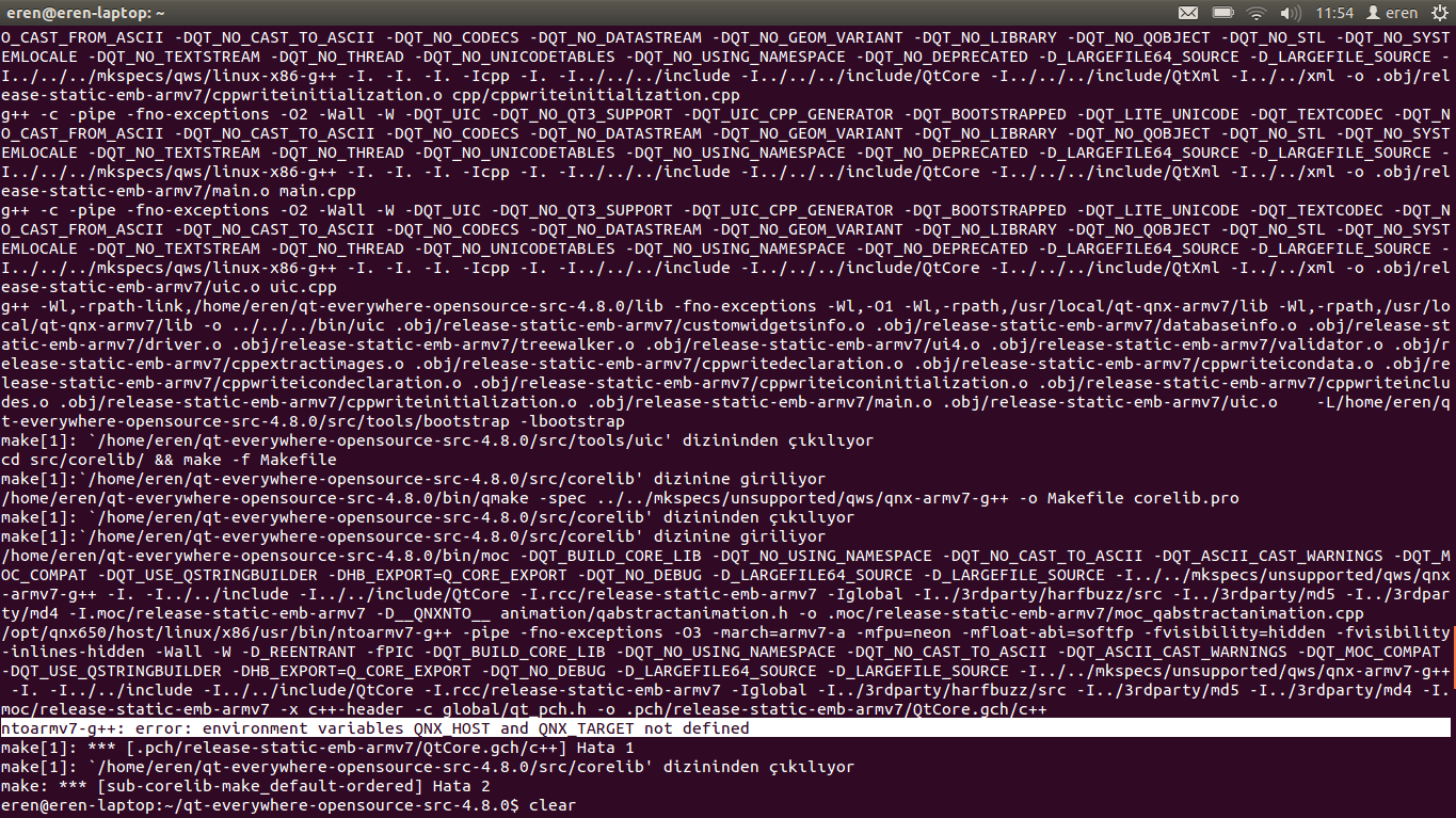

I have new problem make stage.
I am getting the following error in the compilation stage .
"ntoarmv7-g++: error: environment variables QNX_HOST and QNX_TARGET not defined"

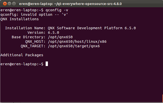

qconfig (image2.png)
qconfig -v (image3.png)

Re: Qt Library Adding
Eren-
Your .configure. line is wrong for 4.8.x .  -xplatform has changed from
-xplatform unsupported/qws/qnx-i386-g++
to
-xplatform qws/qnx-i386-g++
I might help to follow these notes:

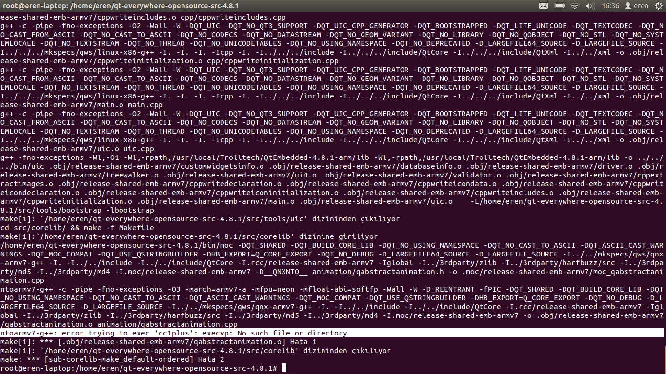

I'm follwed this document but i have a new probelem.
"ntoarmv7-g++: error trying to exec 'cc1plus': execvp: No such file or directory"
You can look image.png for information

Hi Dennis,
I changed computer at the office. I wrote the previous message
Let me tell you the problem. I have two different problem.
I'm getting this problem when I'm super-user : ntoarmv7-g++: error trying to exec 'cc1plus': execvp: No such file or
directory
I'm getting this problem when I'm normal-user : ntoarmv7-g++: error: environment variables QNX_HOST and QNX_TARGET not
defined
What can I do about it?
Thanks for help

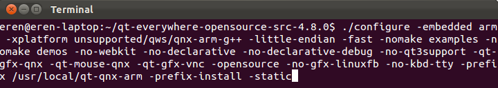

also i used  this config:
./configure -embedded armv7 -xplatform qws/qnx-armv7-g++ -little-endian -fast -nomake examples -nomake demos -no-webkit
-no-declarative -no-declarative-debug -no-qt3support -qt-gfx-qnx -qt-mouse-qnx -qt-gfx-vnc -opensource -no-gfx-linuxfb -
no-kbd-tty -prefix /usr/local/qt-qnx-armv7 -prefix-install -static
qt-everywhere..4.8.2.tar.gz

Attachment: Image image2.png 25.56 KB
Attachment: Image image3.png 41.96 KB
