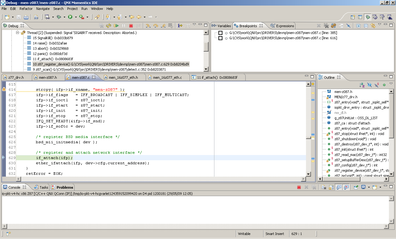

I've some difficulties with if_attach function :
On my HW, there are several network controlers that shall be initialised at the same time.
To do such, I dectect each ctrls and puts it's information in linked list.
To register my driver to the network stack, I need to call if_attach each time there are ctrls on my HW.
Basicaly, on my develepment system, I have 2 controlers.
Strange stuff : When I call 1 time with my first controler it register the device without any problem.
When I do an ifconfig I ca see my device registered.
When the second controler is registered, I'm catching a SIGABORT signal.
Attached, screenshot of debugger when it occurs.
Do you know why this append ?
Thank you very much.
Attachment: Image reveiving_SIGABORT.JPG 2.83 MB

The stack probably panic()'d.  Check the sloginfo for
more information.  BTW the source for the stack is
in the networking repo in this project.
