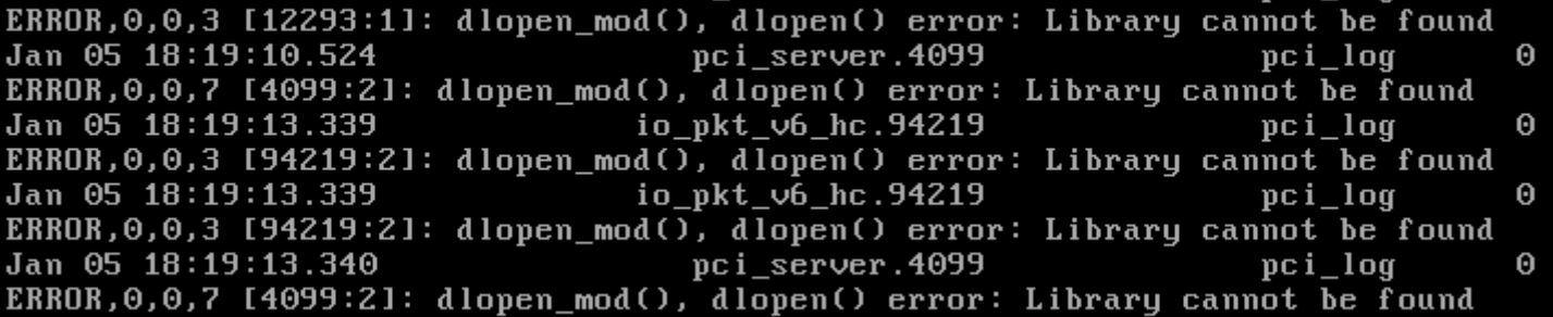

So I tried using the driver you supplied but the result was the same. I am posting a picture of what I am seeing.

Re: QNX7 devnp-e1000.so works for Intel Integrated I350 NIC for x86_64 but not x86_32
I have installed the 32-bit X86 BSP on my development machine, created a boot image and booted my PC with this image.
Both e1000 interfaces on my PC work fine with the 32-bit driver. Are you sure that you are not mixing 32 and 64-bit
executables?
I am fairly certain I am using only 32 bit executables.

Hey Hugh, it appears that I am able to mount a usb drive and there doesn't appear to be issues there. I happen to be
going through the slog2info and found the attached error. It looks like that there is an issue with the pci_cap-0x10 or
pci_cap-0x11
it states that pci_log says that the pci_cap-0x10 file can't be found for my nics.
I also tested this image an alternate server. It was a different model/make server, but it was able to boot the image
and use the nic and io-blk drivers.
So from the image provided, is there an issue with the NIC and driver compatibility?
Scott
01/05/2018 2:59 PM
post118338
Also there is an error appearing in the slog2info with the dlopen_mod(), dlopen()
it is stating Library cannot be found?

01/05/2018 3:11 PM
post118339
Scott,
Don’t worry about the pci_cap-0x10, but you should have one for pci_cap-0x11 as this is MSIX.
Now that you can mount a USB stick, can you please do the following:
pidin in > /path_to_usb/file
pci-tool –vv >> /path_to_usb/file
use –i /proc/boot/* >> /path_to_usb/file
pidin arg >> /path_to_usb/file
Please send me “file” from the USB stick.
Thanks, Hugh.
