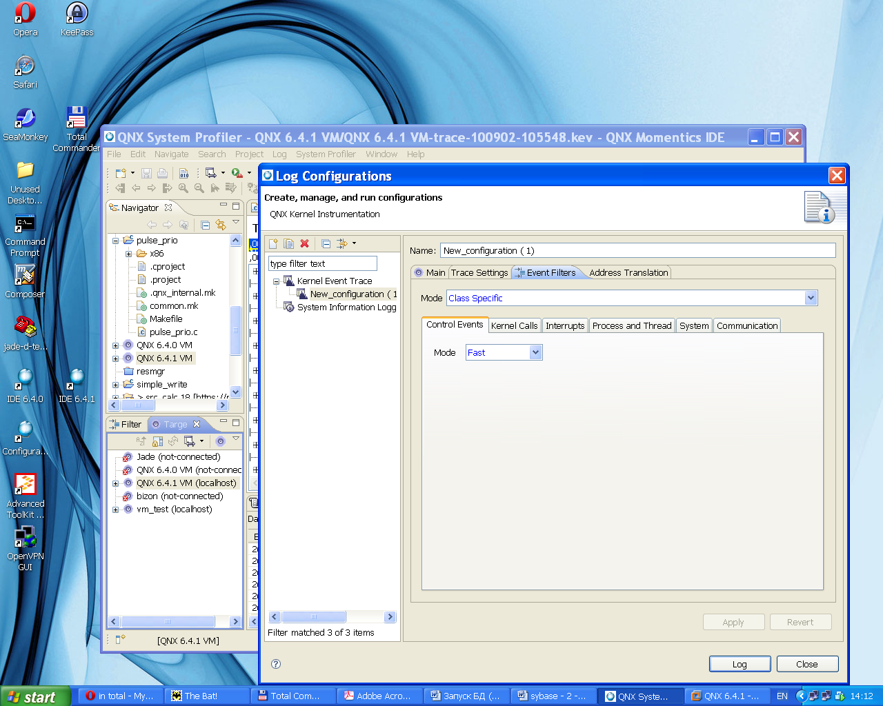

Re: How to fillter User Class events?
09/03/2010 6:20 AM
post65843
That is strangely, because I do not have User Class Tab. Please see attachment screenshot.
09/03/2010 10:04 AM
post65879
which Build Id do you use? Help -> About
I have 2010015 running
And which qconn version are you running?
# use -i qconn

The IDE does not provide the ability to enable/disable user events for kernel logging. There is an open feature request
for adding this functionality, but there is no ETA for its completion.

I understood it. The problem of customer is how to get user events in
Class Specific mode of Events Filter of Log Configuration dialog in
6.4.1.
I have just tried QNX Momentics 6.5.0 with IDE Version: 4.7.0 Build
id: 201006232051 and I can get user events in above mentioned mode!
This is a good news. And still a bad one is that customer is 6.4.1 buyer.
I cannot just say to him - go to 6.5.0 :(
Mike
