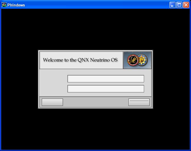

Yes, you do need to have 'inetd' running and /etc/inetd.conf configured appropriately. Remember you also need 'phrelay'
on the target for the actual communication between you phindows host and the target Photon server.
