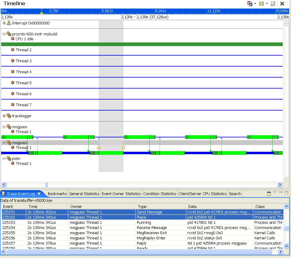

I've noticed bad message passing performance with certain messages sizes on a MPC8313. 1k messages arer slower than 2k
messages.
I've captured this in a kev file. But I just see that going from "Send message" state to "Reply blocked" takes 37 usec
in the 1k case and < 10usec for 2k messages. See attachment.
I'm wondering, if I can dig more deaply into the problem by adding trace stamps into the kernel.
Sönke

You could but you can't use TraceEvent() to do it ... it is a kernel call
and you are already in the kernel (assuming
you are instrumenting the message pass code), you would need to use the
internal trace_* calls in ker_trace or
nano_trace.
However, adding code into the message copy path will have a measurement
effect.  What I'd do first is to use
the trace to look at the overall scenario:
* Length of data/message
* State of receiver
* Length of READY queue's
.. etc
This will allow you to take a first look at the code and understand how the
code path differs in both scenarios
that you are tracing.
