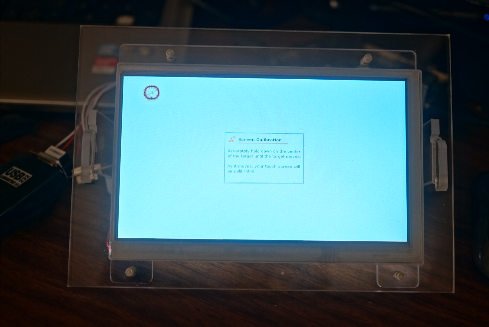

I hooked up the BD-SL i.MX6 board to a 7" touch screen (http://boundarydevices.com/products/7-800x480-display/) and used
the latest BSP for it to build the appsmedia-sample image.
When I try to launch this image I get the screen calibration screen, only its colors are off (blue backgroud instead of
white) and the touch screen isn't working (I'm unable to "touch" the target).
I have used this BSP:
http://community.qnx.com/sf/wiki/do/viewPage/projects.bsp/wiki/FreescaleImx6QSabreLite
without any modifications.
The U-Boot text upon boot is looking good (white) on the screen.
Below is the boot serial output, and a photo of the screen is attached.
Can anyone please help?
Thanks!
