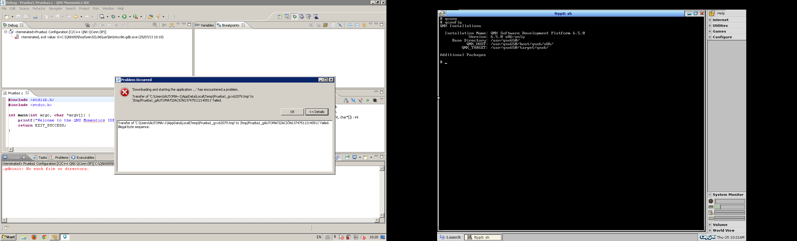

This is the first time that i face a RTOS, and i'm very lost. I have followed the steps of guide: "10 Steps to
Developing a QNX Program: Quickstart Guide [6.5.0]", and when i go to do the step 9 "Starting and debugging" i find a
error during "Donwloading and starting application" process. (i add a capture screen)
My intention is, in the future, integrate QNX neutrino on a beaglebone black board, but, for now, i'm using virtual
machine. Following the steps of guide, i use VMware Player (last versión 5.0.2) and i downloaded and installed, in VM,
the iso with x86 host for this version. Did I need to do some configuration on QNX , that is not indicated in the guide?

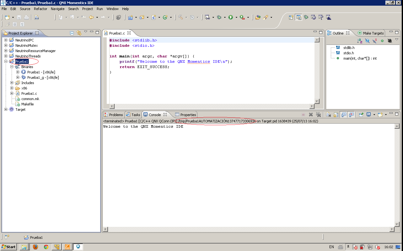

But in the screenshot you see that the name on the target is
concatenated with a "unique" string (I think it may be drived from your
host name). I suspect 'O' with the accent is confusing it.

Thanks Aleksandar,
I don't know why the program change the name of file. The project's name is only 'Prueba1', and the file in /tmp folder
is Prueba1AUTOMATIZACIÓNxxx... Adjunct new capture screen, but now i'm running system from CD.
AUTOMATIZACIÓN is the name of user in this pc, i try change it and try again without boot from CD.

There should be an option in your debug configuration that says "use
unique names" you can uncheck that and the name of the binary on the
target should remain "as-is" without adding "unique" portion.

Thank you so much, Aleksandar.
At the end was the "use unique names" option. Now i can run application without problems, but during load program
console show this warning:
warning: Host file C:/QNX650/target/qnx6/x86/usr/lib/ldqnx.s0.2 does not match target file /user/lib/ldqnx.so.2
