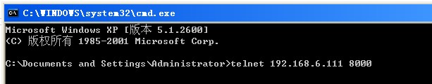

thanks for your reply !
I'm input then command " telnet 192.168.6.111 8000" in the windows cmd commandline , but it was not any result show .
the qconn was prompt int qnx vmware terminal.
any suggestion ? thanks!

Re: QNX Momentics Read Timed out ?
Does it hang like this or it times out eventually?
That would explain why IDE times out it is waiting for response.
Does you target has telnet? Can you telnet to a target and on the target
type
telnet localhost 8000
Did you run qconn with any options?
Type on the target please
pidin a | grep qconn

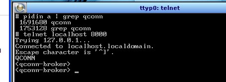

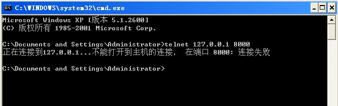

the command result int qnx was showed on the picture which i'm upload.
i'm have no run qconn with other options,all option is default , i think is nothing about the option, i try to up it
priority,but it is no useful.
I asked to telnet to TARGET and run comman on TARGET not on host.
Please provide output of these commands:
