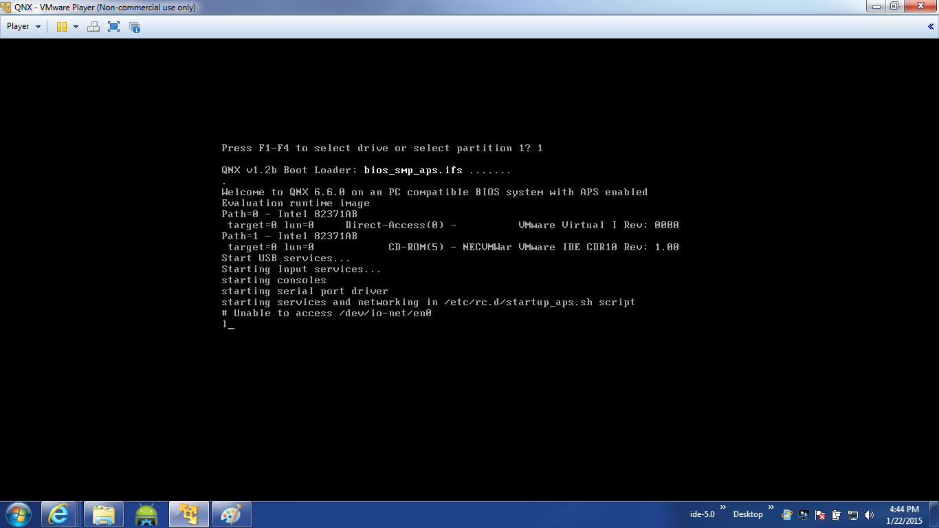

Hi Shiva,
Have you tried going to the Apps and Media 1.1 on Foundry 27? Look for the
document "Working with Target Images". Chapter one provides step-by-step
instructions for copying a reference image onto a target, including for
VMWare.
Have fun.
N
On 2015-01-22 16:45 , "shiva aetherpal" <community-noreply@qnx.com> wrote:
>Hi Nicola,
>yeah I have seen those documents. Here is what I am trying to do.
>I am planning to do QNX app development for car infotainment systems who
>are QNX enabled.
>From my basic research, I have to install QNX Software Development
>Program and QNX SDK for Apps and Media. and I have successfully done till
>this. I can also launch QNX Momentics IDE 5.0 and write code.
>Next part is to create a QNX target. I hope there are two ways to do that.
>1. Buy QNX board or device and connect to PC and start working as
>provided steps.
>2. Create VMware and install QNX RTOS on that slice, which will work as
>Target for deployment. (just like emulator).
>I want to create target as mentioned in the 2nd step. I tried to follow
>the steps mentioned in section "3. Installing the QNX Neutrino RTOS on
>the target system" @
>http://www.qnx.com/developers/docs/6.4.1/momentics/quickstart/about.html.
>But when I do that I get following error. Please find the attachment.
>Or please suggest me if there is any other way of setting up a QNX Target
>for installing apps.
>Thanks

Now I am able to create a Target successfully. I do not know what is the issue, all the time I was following the correct
procedure, but some thing was going wrong. After several trials I could install it properly and run my test
applications.
Thanks for your replies Nicola, they was helpful.
