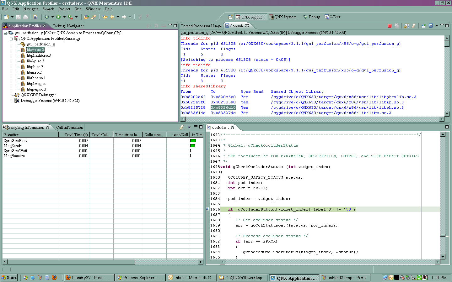

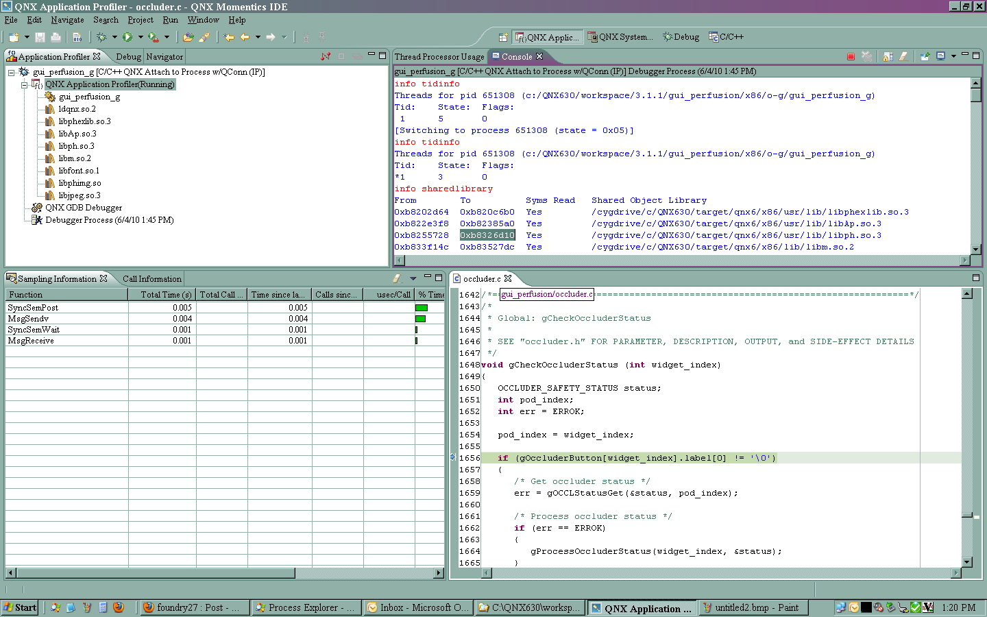

Ok no problem, I'll do my best to explain.
Here are 3 screen captures (see other two threads for the rest).  I can only attach one per thread on this forum.
The first bmp is just highlighting the running App Profiler.  You can see 4 functions listed in Sampling Info view.
The second bmp is highlighting the shared library "ldqnx.so.2" which shows 4 functions.
The third highlights the "gui_perfusion_g" project.  As you can see, no functions are listed even though there are
multiple files and dozens of functions.

Re: Application Profiler Issue (works but no analysis data)
Here's the 2nd bmp
Attachment: Bitmap untitled5.bmp 3.71 MB

Ok. I see now. If you can see on you screenshot you project was running
maybe for 10 msec, it has only 6 samples!
Sampling profiling require process to run for a LONG time doing same
thing to receive anything substantial.
You functions were not hit by sampling at all, because it samples only
each 1 msec. You would need high resolution profiling in this
case. This release you using is very old it does not have function
instrumentation profiling.

doesn't matter how long I run it since I get the same results.  You
mentioned it might be blocked.  I'm not sure if I understand what you
mean by that, but I am fully able to debug the application on the target
with the App Profiler running.  If it is being blocked, then would I be
able to debug?  I would imagine not.
The problem is not with the functions that are being listed, but the
functions that are not.  There are dozens of functions in gui_perfusion
project that are not being listed by the App Profiler.
