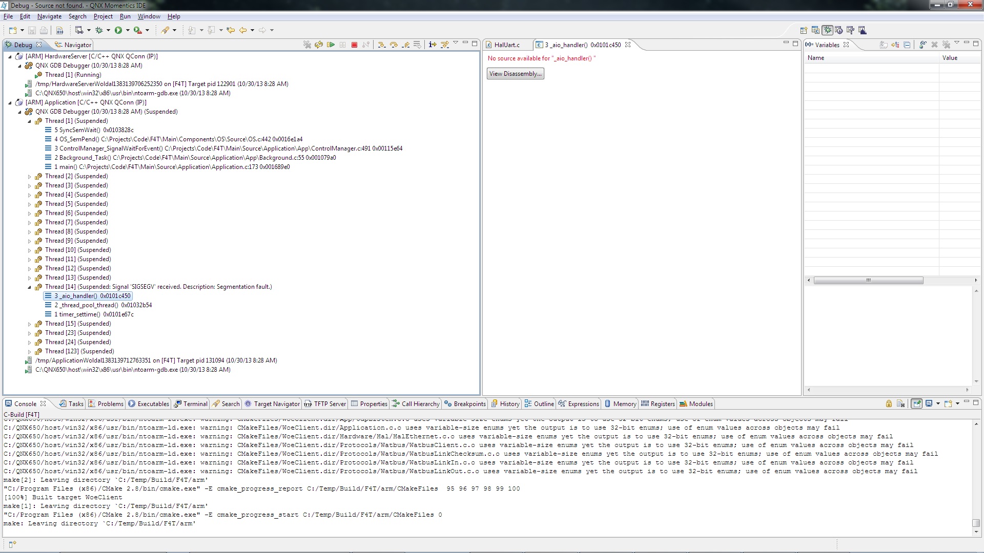

The overly simplistic description of what I am experiencing is a SIGSEGV error within an aio thread. See the attachment
