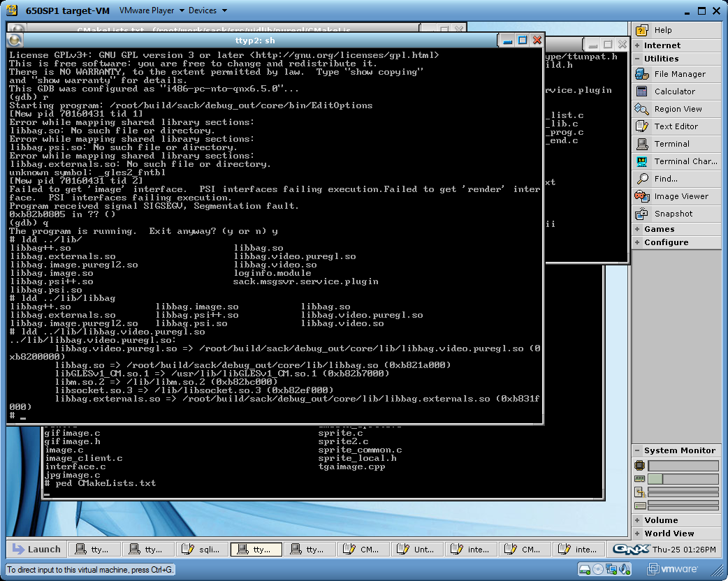

> It is not clear from your post what is your code doing. I am assuming it
> is dlopening libbag.video.pureg.so.
> If so, it is sufficient that you pass '0' as RTLD flags (unless you have
> specific goals).
> To make sure everything resolves correctly: when running ldd (or your
> program), specify LD_BIND_NOW=1
I did this, the output is the same as without the LD_BIND_NOW=1
> e.g.:
> # LD_BIND_NOW=1 ldd ../lib/libbag.video.puregl.so
> Aleksandar
> On 13-07-26 12:32 PM, Mr ee wrote:
> > I have some projects that use GLES2 and I keep getting
> > "unknown symbol: _gles1_cm_fntbl"
> > "unknown symbol: _gles1_fntbl"
> > "unknown symbol: _gles2_fntbl"
> > which I guess are all defined in libEGL.so..
> > but 'ldd ../lib/libbag.video.puregl.so' doesn't complain....
> > Hmm... maybe it's because I'm using RTLD_LOCAL ? hmm no
> > Any hints would be appreciated.
