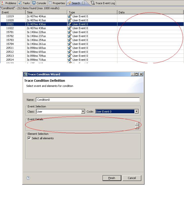

I'm using the latest build of TAU 4.5 dated 20080717.
When viewing the Trace Event Log or custom search, the IDE does not display the 'Data' field for any User Events (see
attached).
User events are inserted using both of the following, where int event is USREVENT 0:
TraceEvent(_NTO_TRACE_INSERTSUSEREVENT, int event, int data0, int data1)
TraceEvent(_NTO_TRACE_INSERTUSRSTREVENT, int event, const char * str)
If I analyze the .kev file with traceprinter, the user data is in the .kev:
t:0x38d7306b CPU:00 USREVENT:EVENT:0, d0:0x7473736d d1:0x00747261
t:0x38d73140 CPU:00 USREVENT:EVENT:0, d0:0x00000028 d1:0x0000004f
Also, when creating a new search, the "Event Details" under the search dialog is surprisingly empty (which normally has
fields for STR, d0 and d1).  See attached.
If the same .kev file is opened on another PC with the exact same configuration, the user event data is displayed
properly in Tau.  Is there a configuration that is hiding the user data in the IDE?
thanks
Attachment: Image traceevent.JPG 81.08 KB
Re: Trace Event Log User Event data field empty in TAU 4.5 build 20080717
attached).
has fields for STR, d0 and d1).  See attached.
Nope, but you may have ended up triggering a bug of some sort.  Is there
anything in the .log file for the workspace
that indicates a silent error has passed through?
You can also try manually specifying the formatting for your user
event.  This can be done via the properties of a
single log file (Right click > Properties > System Profiler ...) or on a
more global level for all log files (Window >
Preferences > System Profiler ...)
The format of the file you are supposed to select here is not documented
(it is in the documentation food chain
somewhere, but not yet in the released documentation) so for the time
being I've included a sample configuration
file that is heavily documented and should be able to get you going.
Thomas
No, the log is empty.  I don't know if I should attempt a full reinstall of QNX as a last resort.  I've had this problem
 since IDE 3.x with QNX630.
> Thomas
Thanks!  Although this did not work on my environment, I was able to successfully test this on other QNX installations
(using the same log file).  The sample configuration documentation was sufficient and it works as expected.
Thanks again,
--nick
Reinstalled QNX632 and the same problem still exists.
There must be some other setup with this PC that is conflicting with eclipse and it's display of certain windows/fields.
  Specifically in this case, the user event data information.
Thanks for your help anyway...
