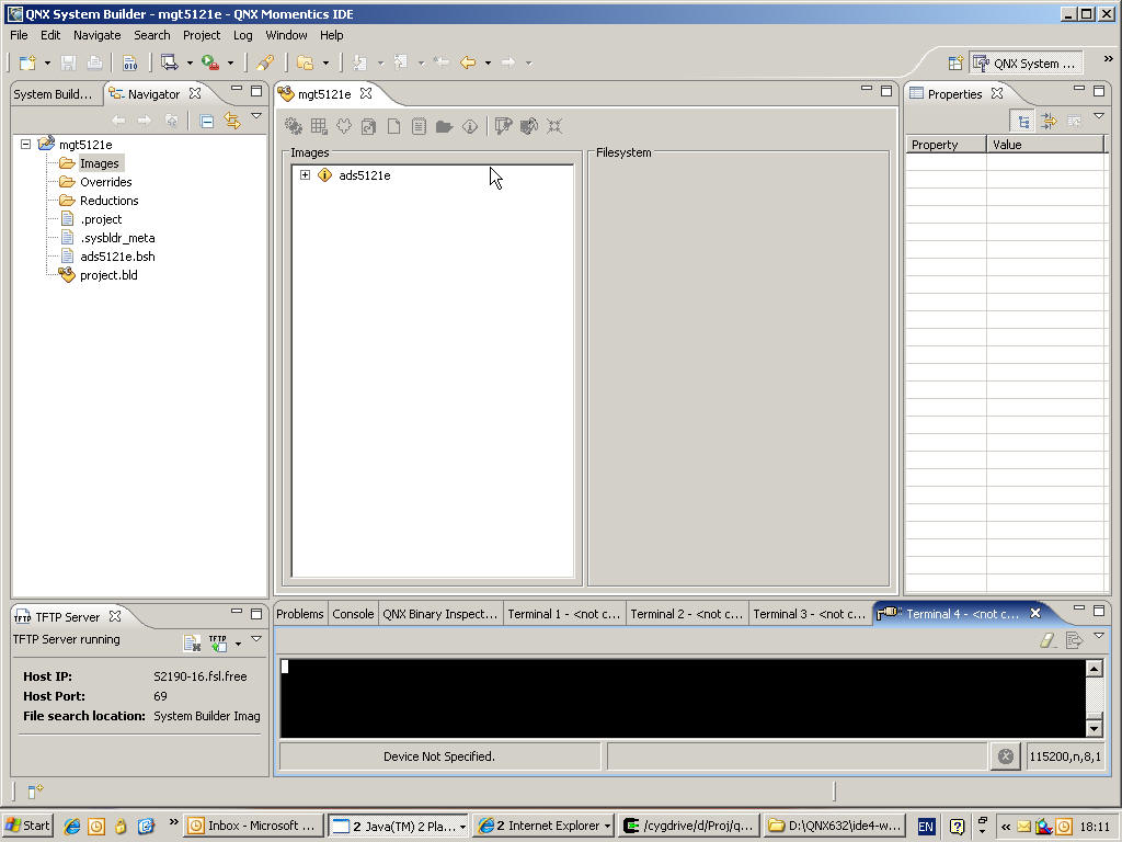

I'm using the QNX® Momentics® Integrated Development Environment Version: 4.0.1, Build id: I20070321. And I can't get
the QNX System Builder's built in serial terminals to work. I installed the QNX Momentics development suite 6.3.2 on my
laptop running WindowXP OS. When I open a terminal by selecting Show View-->Other... from the Window menu and then
select QNX System Builder-->Terminal N (where N is 1 to 4), it shows "not connected", and all 4 terminals don't work.
Attachment: Image Snap1.jpg 114.03 KB

Did you set correct parameters for your serial communication session? You should do it using terminal view menu (right
side of the  view frame top bar.

Thanks. I've got it to work now. I didn't notice that menu view!
