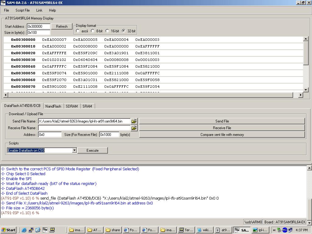

Step 4A: Generate a bootable flash image#
Inside the images directory of BSP, Run the script mkflashimage. This script will create a combined IPL/OS image called ipl-ifs-at91sam9rl64.bin. This image needs to be write onto the DataFlash present on the board. To write this image into DataFlash you have to use SAM-BA programming tool provided by Atmel. This SAM-BA tool also helps to execute TCL scripts on the AT91SAM9RL64 board. Make sure that the jumper J12 and J13 are removed in AT91SAM9RL64 board.

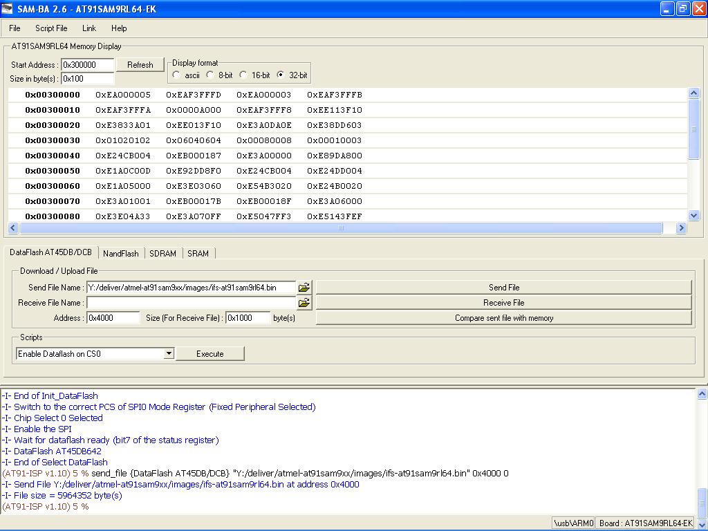

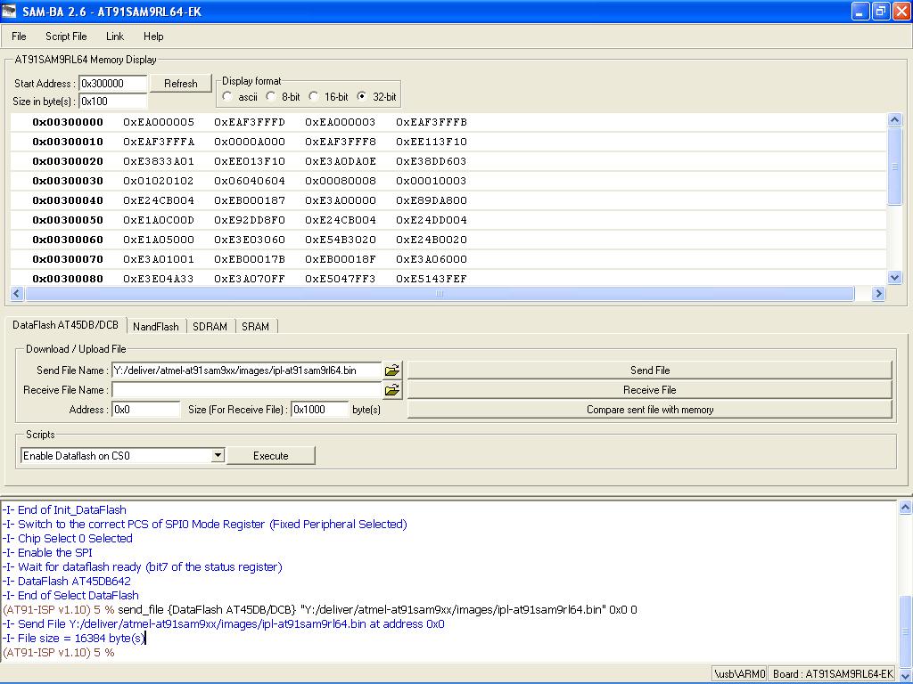

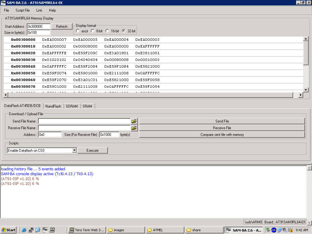

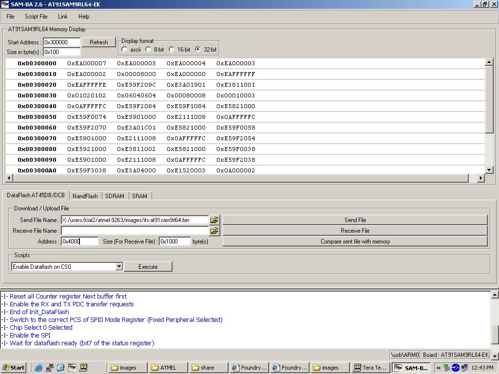

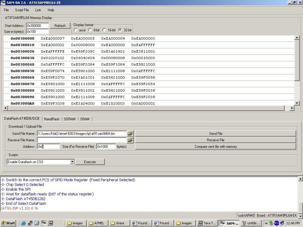

Step 4B: Download the Bootable OS image in DataFLash#
*In your Windows host machine installed SAM-BA application will help you to write the IPL and IFS on DataFlash.
*Connect the board's serial of DBGU with your windows host machine's COM Port.
*You can use Term Tera VT100 which also offers the ability to connect to SSH2 hosts.
*You need to Remove the Jumper J12 and J13 first and reset the Board.
*Now you will see >RomBOOT prompt.
*From the SAM-BA application, Select the communication mode(usb/serial) and set the board to AT91SAM9RL64-EK, Press ok.
*From the ASM-BA application window, select the DataFlash AT45DB/DCB tab. Execute the Enable Dataflash on CS0 script.
*Select the ipl-ifs-at91sam9rl64.bin file to be sent to the target, and then press Send File. It will take a few seconds up to a minute.
*Now on your terminal you will see output as follows:
