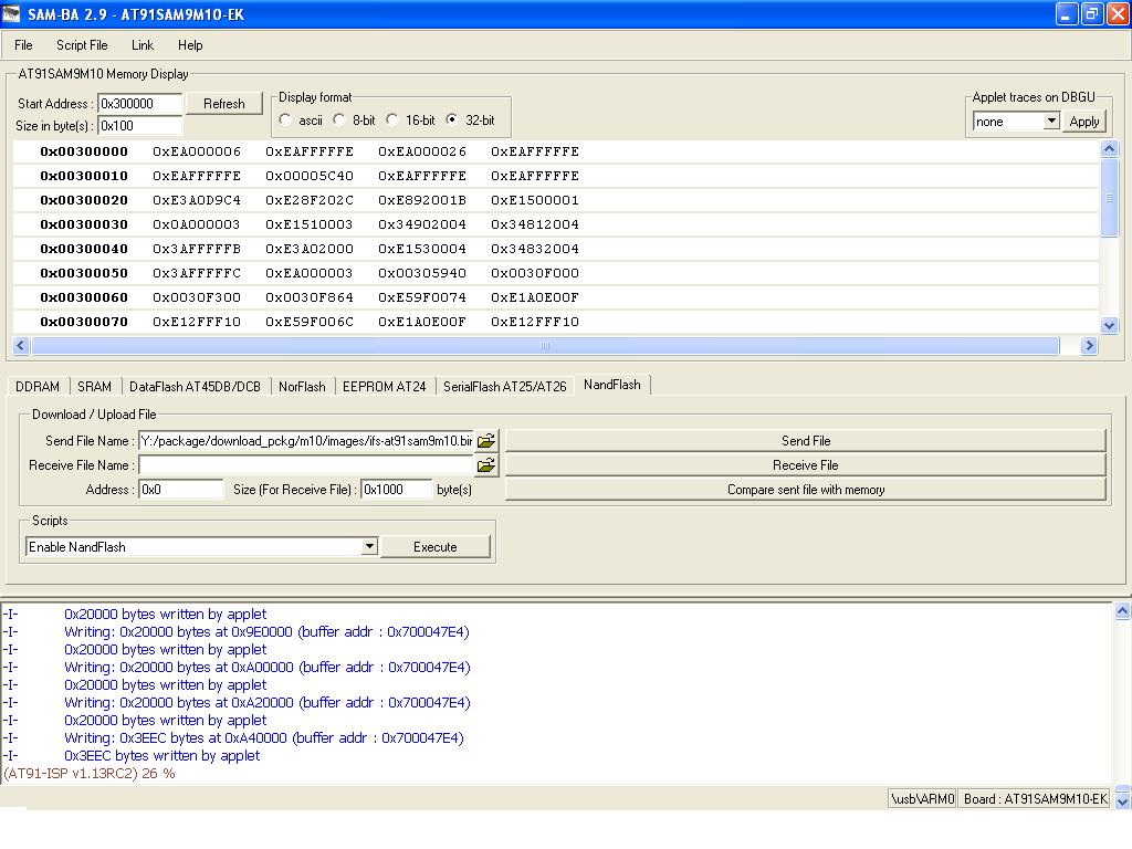

Loading the IFS image using SAM-BA#
  • Select the Nand Flash tab in SAM-BA Application. Execute the Enable Nandflash script.
  • Select the ifs-at91sam9m10.bin file to be sent to the target, and then press Send File. Depending on the size of your file, it will take a few seconds up to a minute.
Nto640AtmelAt91sam9m10EKEVBTrunkReleasenotes/ifs.JPG

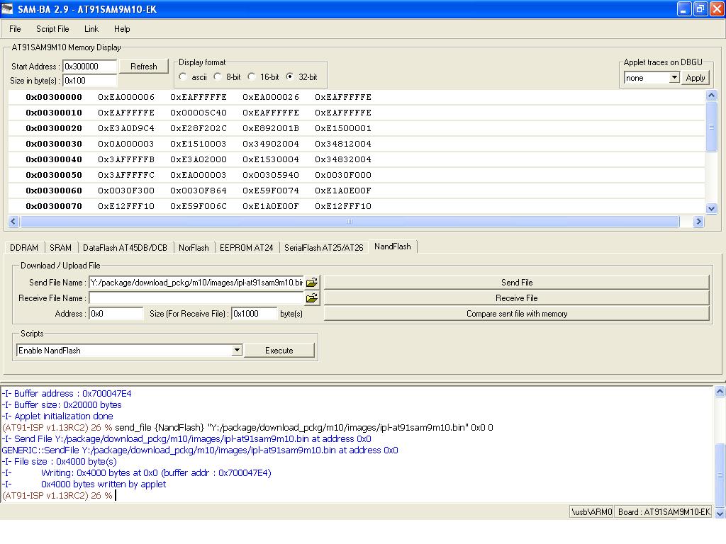

Step 3B: Reprogram the IPL.#
In case if Board is new or IPL gets corrupted, We can reprogram IPL using SAM-BA application.
  • Select the Nandflash tab in SAM-BA application window, . Execute the Enable Nandflash script.
  • Select the ipl-at91sam9m10.bin file to be sent to the target, and then press Send File. It will take a few seconds up to a minute.
  • Sanpshot is as follows:
Nto640AtmelAt91sam9m10EKEVBTrunkReleasenotes/ipl.JPG
