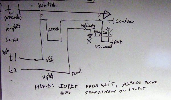

Colin's Scenario#
  1. Thread bob1 in user process Bob, opens a file on resmgr nfs
  2. Thread bob2 in user process Bob, opens a file on resmgr io_pkt
  3. bob1 mmaps its nfs fd, which causes
  4. proc to run and lock process Bob's aspace
  5. bob1 then reads from its fd which faults
  6. proc runs to handle bob1 fault
  7. meanwhile, bob2 does a read on io-pkt
  8. bob2's read causes io-pkt to run but it faults on bob2's buffer, so enters page wait
  9. note that io-pkt cannot exit page wait until Bob's address space becomes unlocked
  10. remember bob1? bob1 had faulted reading it's memory mapped nfs file, a proc thread handles the fault by reading nfs
  11. nfs happens to read io_pkt, which causes it to send to io_pkt
  12. but io_pkt is single threaded, so nfs goes send-blocked
  13. note proc wil not release the aspace lock on BOB until io_pkt replies to nfs and returns to proc
  14. io_pkt's single thread is in page wait for bob2, which cannot be processed because Bob's aspace is locked
  15. bob's your uncle
See the whiteboard snapshot mmap_lockup_1.gif, attacched.

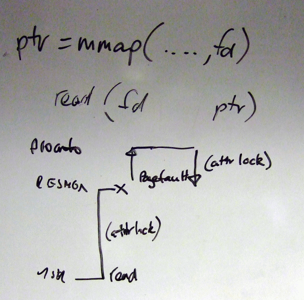

Brian's Scenario #
  1. user thread Bob mmaps an already open fd: ptr = mmap(...,fd)
  2. user thread Bob calls read() on the same fd, using the same ptr as the output buffer: read(fd, ..., ptr)
  3. read() is the resmgr library locks the tructure of the file, as part of normal resmgr handling.
  4. this is the first read, so the memory access to the file faults
  5. a proc thread runs to handle the fault and issues a read on the same fd
  6. proc thread calls read(), in the resmgr library, which also tires to lock the same attribute
  7. the proc thread hangs forever
See the whiteboard snapshot mmap_lockup_2.gif attached.
