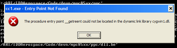

When trying to run make form a windows command line I get the attached error.
Where is the cygwin1.dll supposed to be located and what version should I have?
Kevin
Attachment: Image ErrorWhenCMDLineMakeInvoked.jpg 63.77 KB

Do you have more than one cygwin in your path? 6.3.2 uses
cygwin-1.5.24-2 and it should be located in $QNX_HOST/usr/bin/
If you have more than one, you should only use the latest as cygwin
maintains backwards compatibility but not forwards compatibility.

You'll likely find a second older cygwin dll in
$QNX_HOST/usr/photon/bin. It is used only for phab for windows but since
it's not in the path it shouldn't be loaded (unless you added it to your
path).
> That would mean being able to see into the future.  If that ever happened, we'd run out of software to develop.
:D
The error you're seeing happens when the cygwin application had been
built against a newer version of cygwin than the one loaded. It's
versionitis for sure.
Ryan Mansfield

Does it use the PATH var to find cygwin1.dll?
Looks like my DxDesigner (Mentor Graphics tool) has a bunch.
Kevin
Re: Okay, one more error and I'll stop hogging the forum
Windows has different modes for loading dlls (safe, unsafe?) but both
search the PATH as a last resort. I think in both modes Windows looks in
the applications directory, then the current directory, then a bunch of
system directories and finally it searches the PATH.
Ryan Mansfield
Fixed.  Mentor was the culprit.  Seems to run with the new DLL just fine.
Thanks for your help
Kevin
