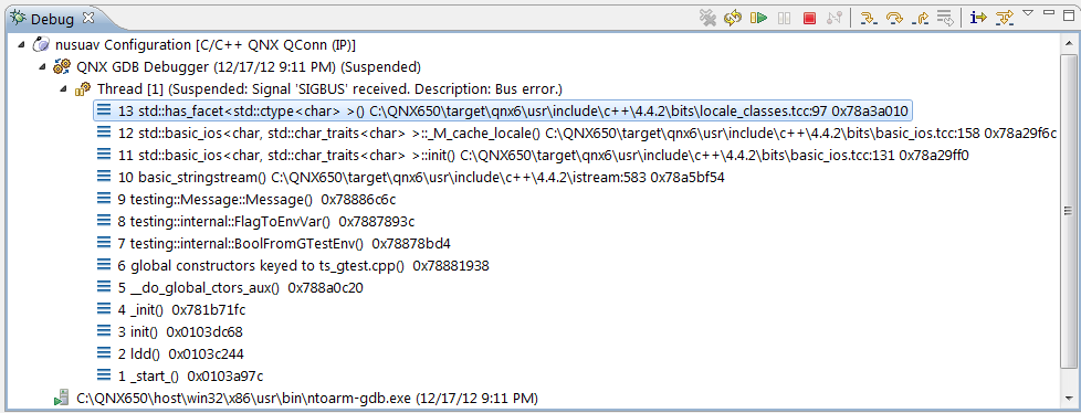

I am debugging an opencv application on the OMAP3530 processor with QNX 6.5.0. I have managed to build the OpenCV 2.3
library and compiled the program. When i tried to debug the application in the QNX Momentics IDE, a SIGBUS error
happened which was shown in the screen shot I have attached. I guess there was some inherent link errors in the OpenCV
library I built? How should I check where the error happened? Would like to seek your suggestions. Thank you.
Eric
Attachment: Image debugWithLib.png 36.93 KB
