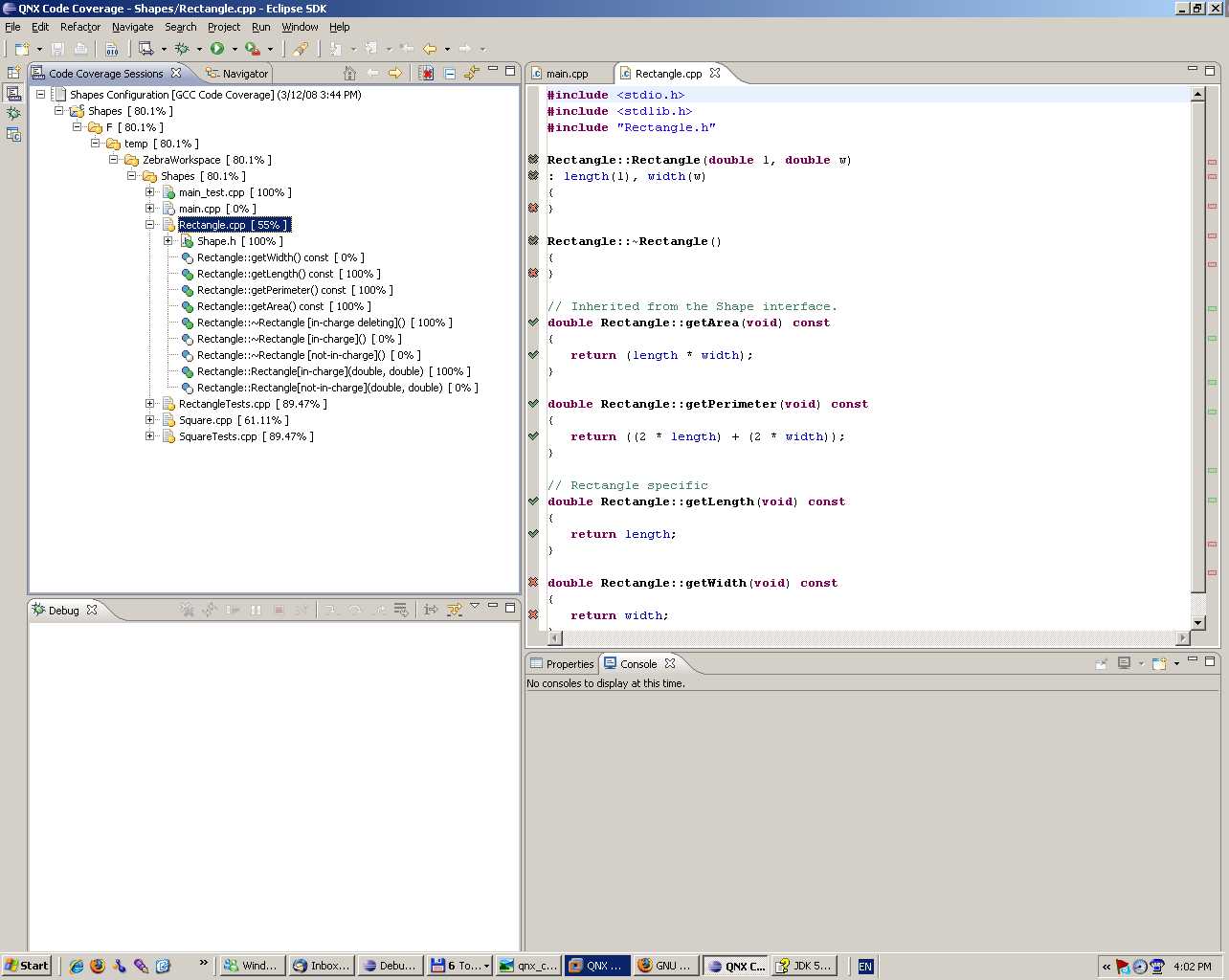

I built your test case on 4.2.1 and ran code coverage session using the latest code. I attached result to this post
(just a screen shot). Do these results make sense?
RE: RE: Code Coverage doesn't seem right
03/12/2008 4:37 PM
post5747
These numbers certainly look better, although I'm not sure they're
completely accurate.
I'm still curious why the constructor and destructor have "uncovered"
code in them, even though I know they're being called. It's contributing
to the coverage number for the Rectangle.cpp file being too low (55%).
From the looks of things, the only function not called is
Rectangle::getWidth(), which should yield a higher coverage number for
the whole file (maybe 80% or so)...
Thanks!
Mike
From: Alex Chapiro [mailto:achapiro@qnx.com]
Sent: Wednesday, March 12, 2008 4:16 PM
To: general-toolchain
Subject: Re: RE: Code Coverage doesn't seem right
latest code. I attached result to this post (just a screen shot). Do

Yes, I agree, numbers still don't look credible for C++ programs (not
always, I'd like to say:-). I'm working on fixing this problem and hope
next integration build will bring essential improvement
