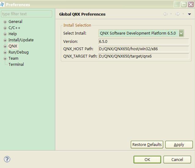

thx about your help, but i'm a rookie about QNX. Can you give me a set of more detailed opration steps about the
approaches you just mentioned.
By the way, in Window->Preferences->QNX, it shows as the pic in accessories, and in Select Install there's just one more
 option, which is "use environment variables". I have no idea about switching to use 6.3.2 SDP.
Attachment: Image show.JPG 33.74 KB

You need to have 6.3.2 installed in your development machine. Please
refer to this online IDE users' guide doc for version co-existence.
http://www.qnx.com/developers/docs/6.5.0/topic/com.qnx.doc.ide.userguide
/topic/concepts_COEXIST_.html

RE: help--about lower version QNX and higher version Momentics
You need to install Momentics 6.3.2.

Re: RE: help--about lower version QNX and higher version Momentics
I could successfully build for 6.3.2 (x86) with the following setup:
- installed Momentics 4.6 (for 6.4.1)
- installed Momentics for 6.3.2 on another machine
- from that, copied the *target* branch into 4.6
(If I understand correctly the target path can be specified using the config utility, but I did not know that then)
And... it just worked.
I tried the same with Momentics 4.7 and building code seems to work, but 4.7 has some problems with qconn from 6.3.2. So
 for 6.3.2 targets I stay with 4.6.
Saul

There is qconn patch and some other target patches for 6.3.2 that allow
run with IDE 4.7
See
http://community.qnx.com/sf/wiki/do/viewPage/projects.ide/wiki/Builds_Tau_Integration
(Before you install)
