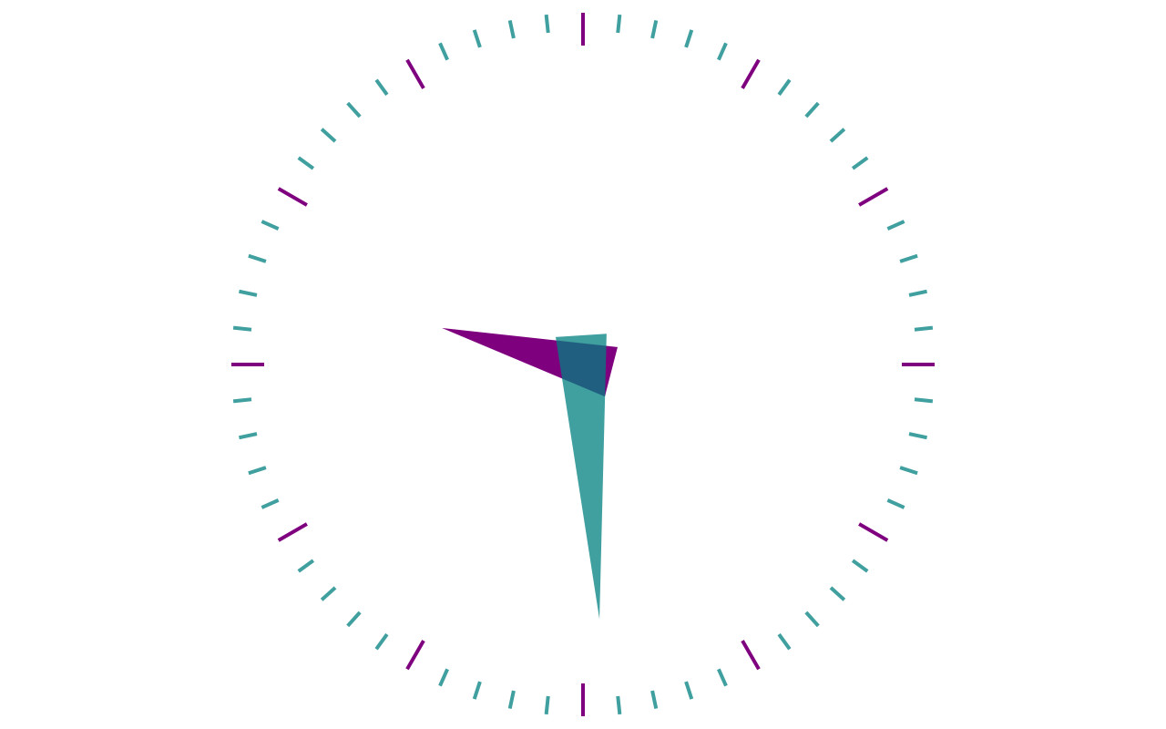

Okay guys, thanks for your help so far. The problem was indeed that the /usr/lib/libfontconfig.so and .so.1 were missing
. I added them to my build and now I Qt does start up and show something (though not always) - analogclock does show
something (I'll attach a screenshot, I have a sneaky feeling it's missing some letters?)
In general, fonts don't show. I noticed that the folder QT_QPA_FONTDIR=/home/qt5/lib/fonts doesn't exist. Did I miss
something during my first build? I do have two files libfreetype.so and .so.1:
