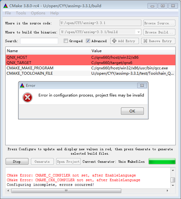

I use cmake-gui Specify the toolchain-file, but get an error about "project files may be invalid",Similar to the
attachment pictures
Attachment: Bitmap error.bmp 1.06 MB

Hi:
As you say,build 3.3.1 get error about BaseImporter.cpp,but I build 3.1.1 or 3.2 get error about ImporterRegistry.cpp,
I think this is caused by the same reason, I am looking for a solution.
