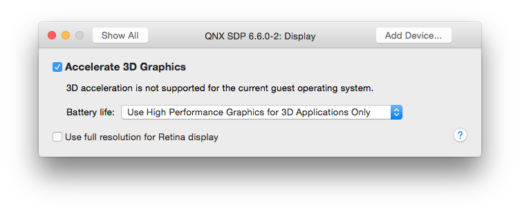

I recheck graphics on vmware and found a warning :
[image: Hình ảnh nội tuyến 3]
Can you teach me how to enable 3D graphics ? I want to build Qt5 with GUI

I get the error you're seeing when I don't enable 3D graphics. Does VMWare Workstation allow you to check the box
despite the "3D accelerations is not supported in this guest operating system" message?  In VMWare Fusion, I'm able to
do this and then screen is able to start.  What's your host OS?
I don't have TeamViewer.
James
Attachment: Image Screen Shot 2015-08-31 at 10.22.30 AM.png 54.7 KB
