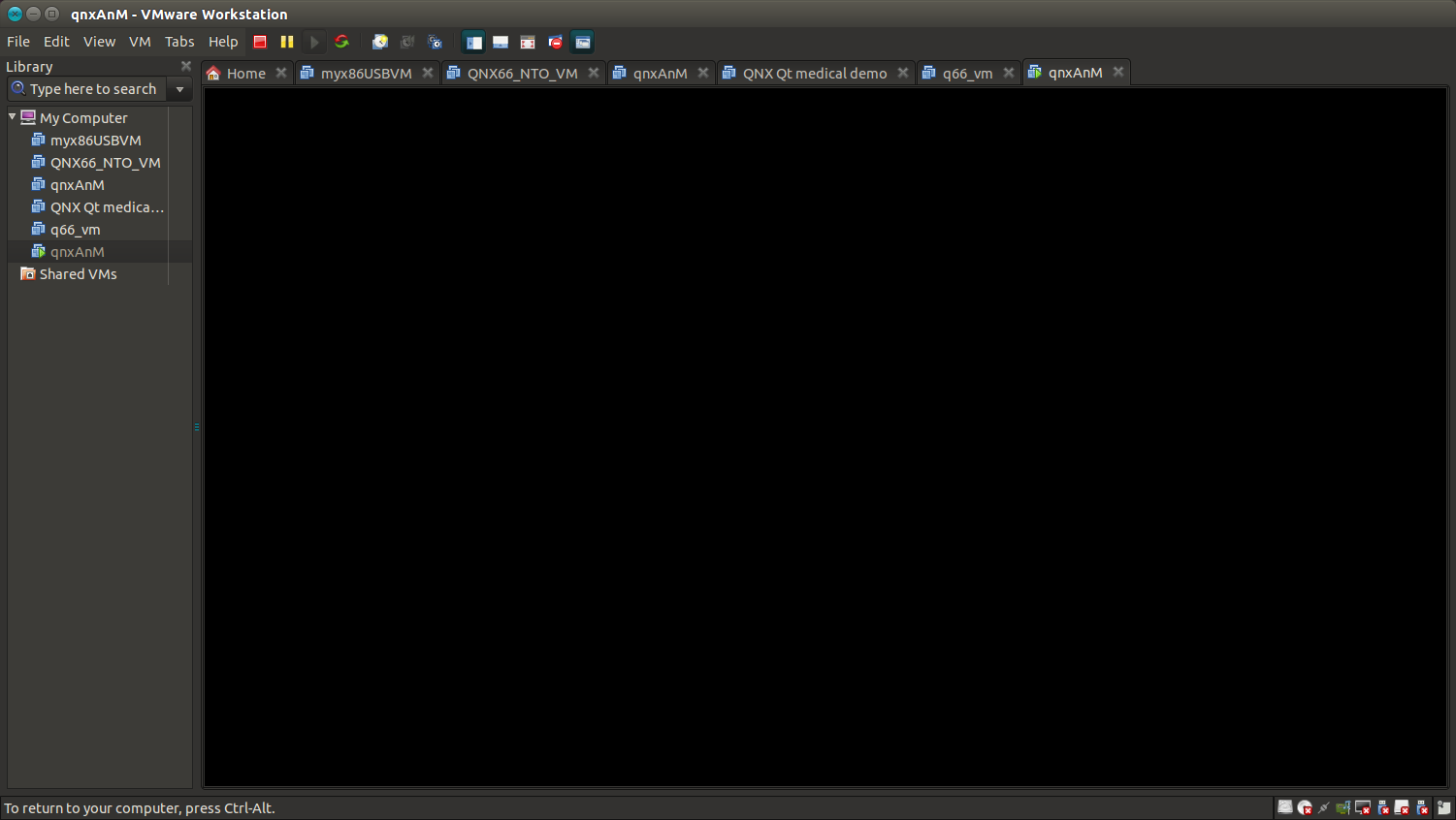

The AnM screen is still showing blank after the bootscripts and invocation of all relevant drivers. Attached is the
screen display. FYI, the system was running, just without showing anything on screen. How do I know, because I can ssh
to it.
Any comments or suggestions please?
Attachment: Image AnM-blankScreen.png 67.72 KB
