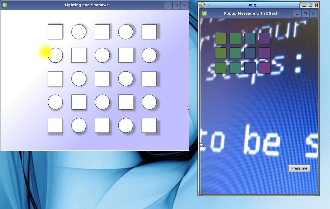

I've also enhanced this version so that it can support running Qt programs under Photon.   The implementation is
flexible, and the same modules can be run with or without Photon without recompiling.
The attached jpg shows two Qt demo programs running both with and without the Photon Window frame.
Currently I only support 32bit ARGB video mode.   Also, note that when in the Qt window, Qt provides the cursor image.
 This leaves a cursor visible in the Qt window at all times, even when the system cursor leaves the window.

Attachment: Image phqt.jpg 85.68 KB
