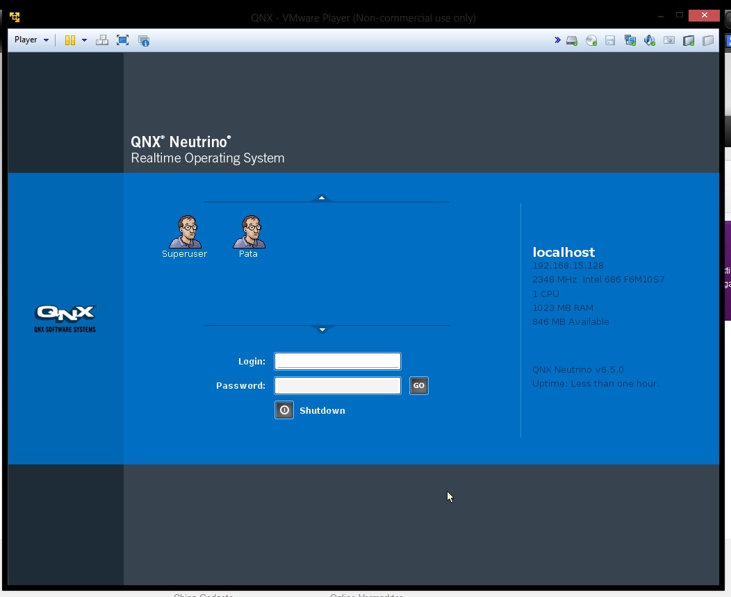

Re: Problem with qtEasy-example on QNX 6.5
No, the login is a nice looking picture where i can use my mouse to select the users or click some buttons
I added a picture of the login screen.
Attachment: Image login_qnx.jpg 89.92 KB
RE: Problem with qtEasy-example on QNX 6.5
Click on the shutdown option on that screen, and choose exit to text mode.

Re: RE: Problem with qtEasy-example on QNX 6.5
Well.. I didn´t see that..
Head -> table -> table -> table
Thx! I will try this tomorrow and post here again then.
n8
Now it is running :)
