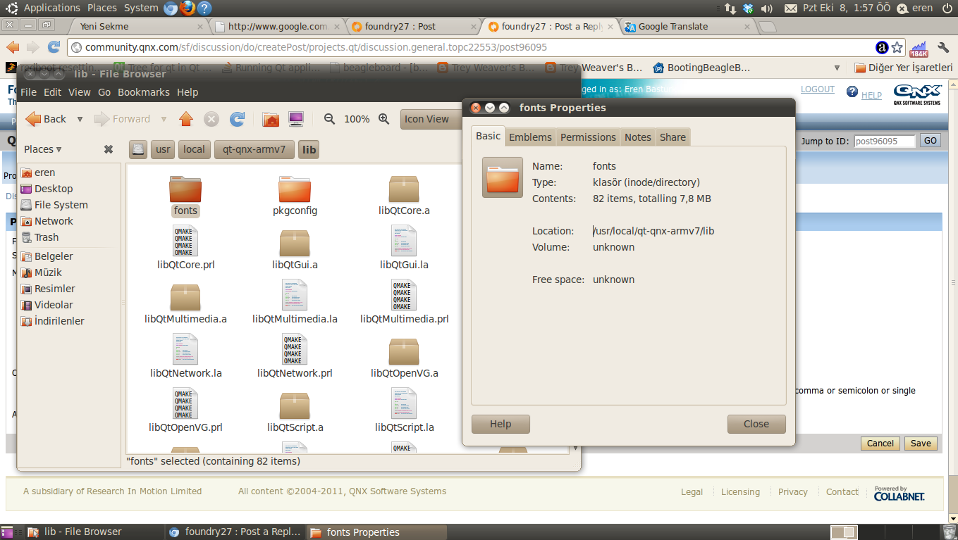

Re: Qt Running Error
I don't include font. I used 4.8.2 for create qmake. Also add prefix=/usr/local/qt-arm-v7 paramter when i creating qmake
My fonts file /usr/local/qt-qnx-arm-v7/lib/fonts. You can look image.png
how can i include this fonts?
I need information like fonts location on beagleboard image
Attachment: Image image.png 215.5 KB
You willl have to experiment.  I can't know for sure.  I told you where I put the font files on my image.
