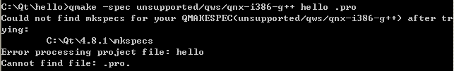

回复: Re: qmake-qnx
i have installed qt-creator-win-opensource-2.4.1.exe and qt-win-opensource-4.8.1-mingw.exe in my winxp .when i enter cmd
 ,run qmake_qnx it shows
i run make
need i unistall the qt programs ,or what should i install.

Re: 回复: Re: qmake-qnx
Have you installed QNX Momentics?  This "make" has to be first in your path.
C:\QNX650\host\win32\x86>usr\bin\make -v
GNU Make 3.81
Copyright (C) 2006  Free Software Foundation, Inc.
This is free software; see the source for copying conditions.
There is NO warranty; not even for MERCHANTABILITY or FITNESS FOR A
PARTICULAR PURPOSE.
This program built for Windows32
回复: Re: 回复: Re: qmake-qnx
thank you for your quick reply ,this is the best answer i have got.the "make" is  really the first step ,but i encounter
 the new problem
2012-05-18

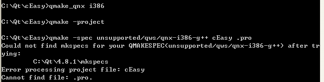

RE: Re: 回复: Re: qmake-qnx
According to the picture, you are still running...
qmake_qnx i386
then
qmake -project
Don't run "qmake -project" - run "make" after "qmake_qnx i386" as in the .pdf.

回复: RE: Re: 回复: Re: qmake-qnx
this the qmake_qnx  i got
@if "%1"=="" goto help
@call pwd >temp.bat
@set /p   PROJ_DIR= <temp.bat
@del temp.bat
::@echo %PROJ_DIR%
@FOR %%i IN (%PROJ_DIR%) DO @SET PROJ_NAME=%%~nxi
::@echo project name: %PROJ_NAME%
::echo %1
@if "%1"=="arm" set ARCH_DIR="armle"
@if "%1"=="armv7" set ARCH_DIR="armle-v7"
@if "%1"=="i386" set ARCH_DIR="x86"
::@echo %ARCH_DIR%
qmake -project
@echo QT += core gui script declarative %QT_MODULES% >>%PROJ_NAME%.pro
@echo OBJECTS_DIR += %ARCH_DIR% >>%PROJ_NAME%.pro
@echo TARGET = %ARCH_DIR%/%PROJ_NAME% >>%PROJ_NAME%.pro
@echo QMAKE_CXXFLAGS += %QT_CXXFLAGS% >>%PROJ_NAME%.pro
qmake -spec unsupported/qws/qnx-%1-g++ %PROJ_NAME%.pro
@goto exit
:help
@echo .
@echo %0 runs both "qmake -project" and "qmake" resulting in a Makefile
@echo .
@echo First parameter must be desired architecture - i386 or arm or armv7
@echo .
@echo .
 :exit
in the .bat,is the sentence in red the reason?
i have installed qt-creator-win-opensource-2.4.1.exe and qt-win-opensource-4.8.1-mingw.exe, need i uninstall them all
for the first?!

RE: RE: Re: 回复: Re: qmake-qnx
Yes, now I see where that line is coming from :)   I assume you cut_and_paste qmake_qnx.bat from the pdf and maybe this
is causing the problem.
File qmake_qnx.bat in this archive.  Extract it and use it instead of the one you have now.
http://dl.dropbox.com/u/13676760/webvu.zip
(The project in this zip should build if you extract and cd to "webvu" - just "qmake_qnx i386" then "make".)

Re: 回复: RE: RE: Re: 回复: Re: qmake-qnx
thank you ,i can do that successfully ,the problem  has bothered me for a whole week,you give me a lot of help.
 and i still have a question,i know that qt can be intergrated with eclipse which makes the developer  convenient,
however, can it be intergrated into the momentics (run and debug in the momentics environment)?
 for me ,the development process seems that ,first i create and debugmy project in the qt sdk for windows , to make it
run correctly ,next,i make it a qnx program by qmake_qnx?
