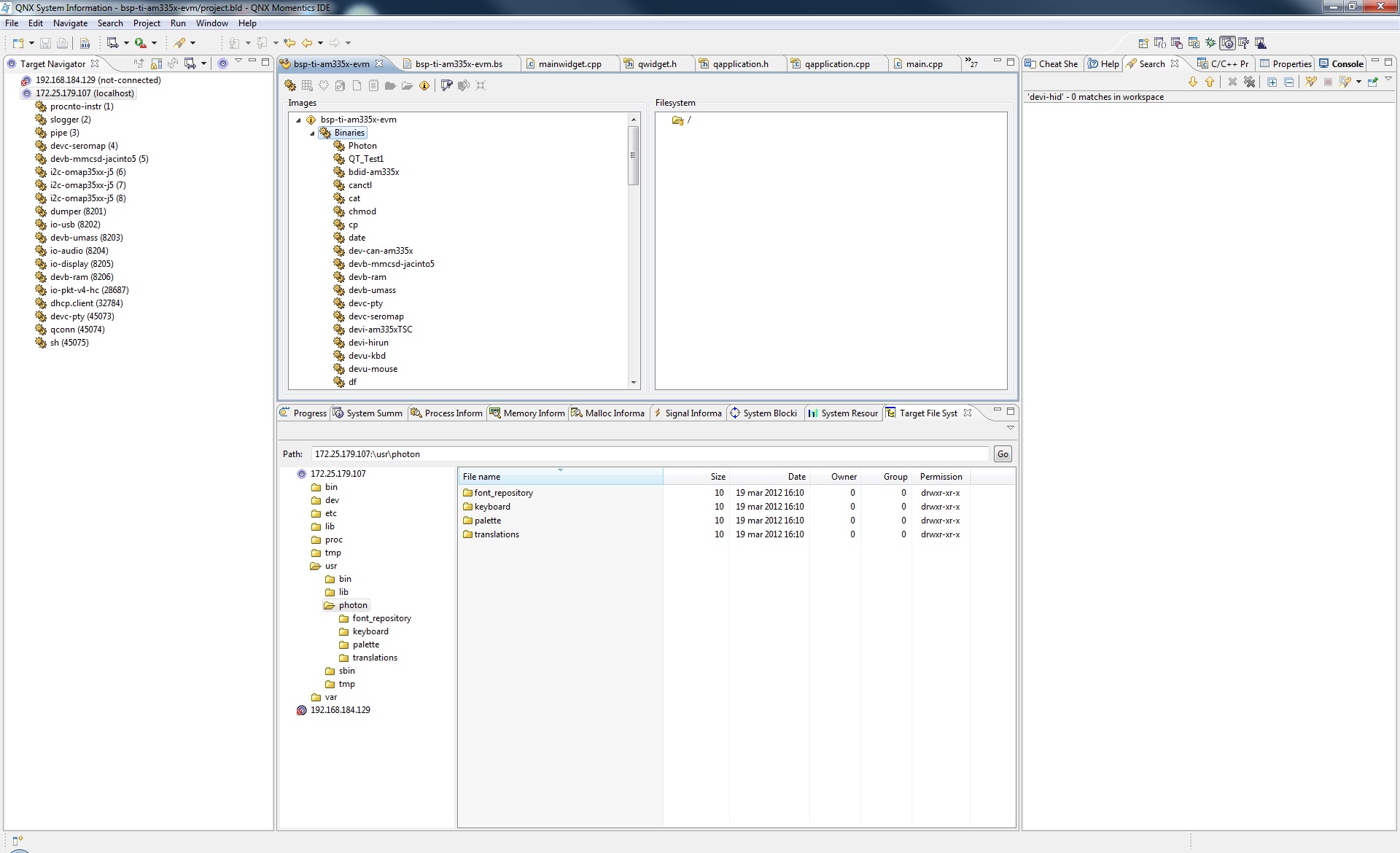

Also I dont have the "devi-hid", actually I dont have the bin directory in "/usr/photon/".
See picture
/Magnus

Well the out-of-the-box bsp is not setup to do Qt.  BSP's are "starting points" that you modify to get what you want.
For example, you need to add the Qt libraries - which I assume you already did.
>>>8202 io-usb -vvv -d dm816x-mg ioport=0x47401400,irq=18 -d dm816x-mg ioport=0x47401c00,irq=19
Probably right (the io-usb line in my post is for x86).
You need ...
/proc/boot/io-hid -d usb /dev/io-usb/io-usb
and
/proc/boot/devi-hid -Pr mouse kbd
The fact that they are not present, just means you need to add them - to /proc/boot.  These components are present in
your 6.5 installation.  In the IDE, right-click on "Binaries" and select "Add binary" to add them.
Eiither start io-hid and devi-hid from the .bsh script to go directly to Qt - or run them manually from a shell before
you start cEasy.
