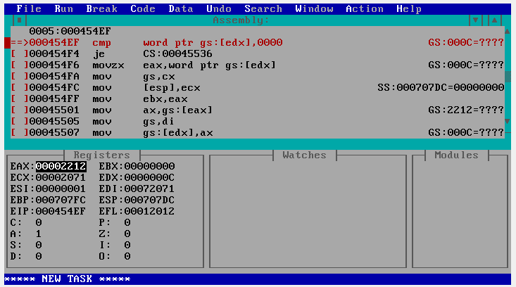

.  The process crashes out with Net not long after it.  On the system we have dumper running and when we have looked at
the dumps even though we cannot tell what it is doing the 3 crashes we had dumps for all terminated on the same
instruction.  I am hoping someone here might be able to aid diagnosing Socket.
I have attached the snippet from wd utility that we get.  The issue is not deterministic.

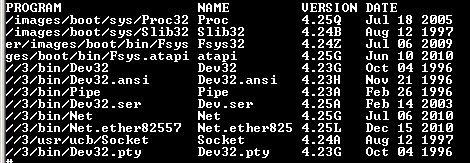

I have attached screenshot of sin ver output to give versions.

2.  Any guidance based on the view of the dumper output.  (I appreciate it probably gets nothing)
I can supply the dump file if needed
