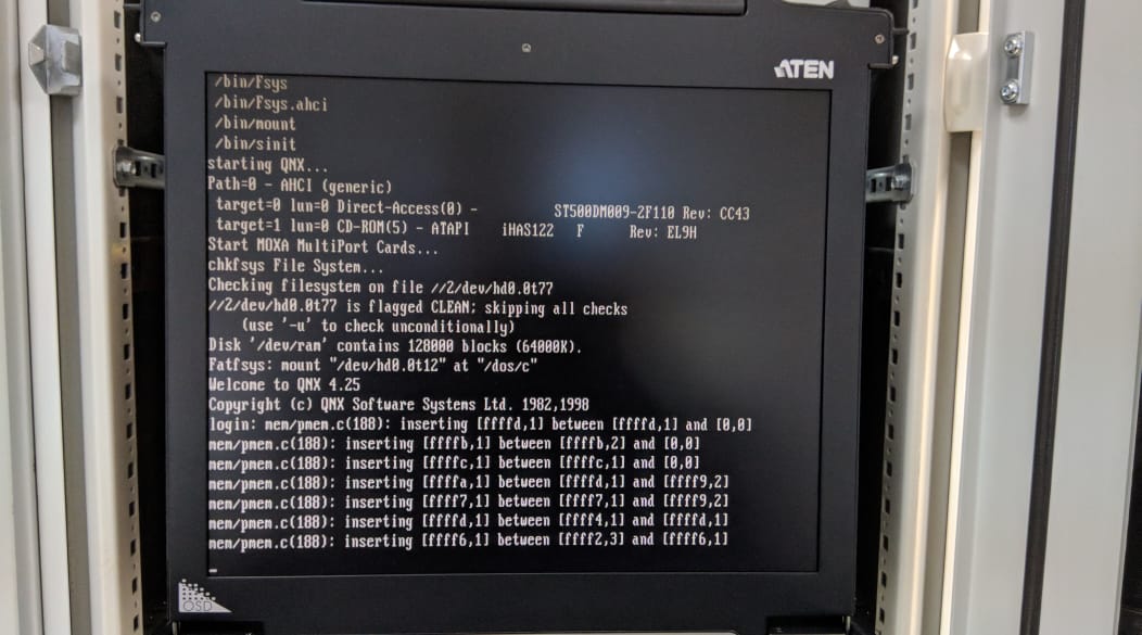

On one of the controllers with QNX4.25 we get an irregular OS crash (attached photo).
"mem / pmem.c (188) inserting [fffff, 1] between [3271, d] and [fffff, 1]"

The controller uses an industrial PCI-6028 board, MOXA multiport boards (4 pcs., 8 ports each),
updated driver Dev32.ser .
Have you come across a similar emergency conclusion? What could be the reason?

Is it HW issue or it repeats on several different HW? In first case your HW is required to debug the issue.
