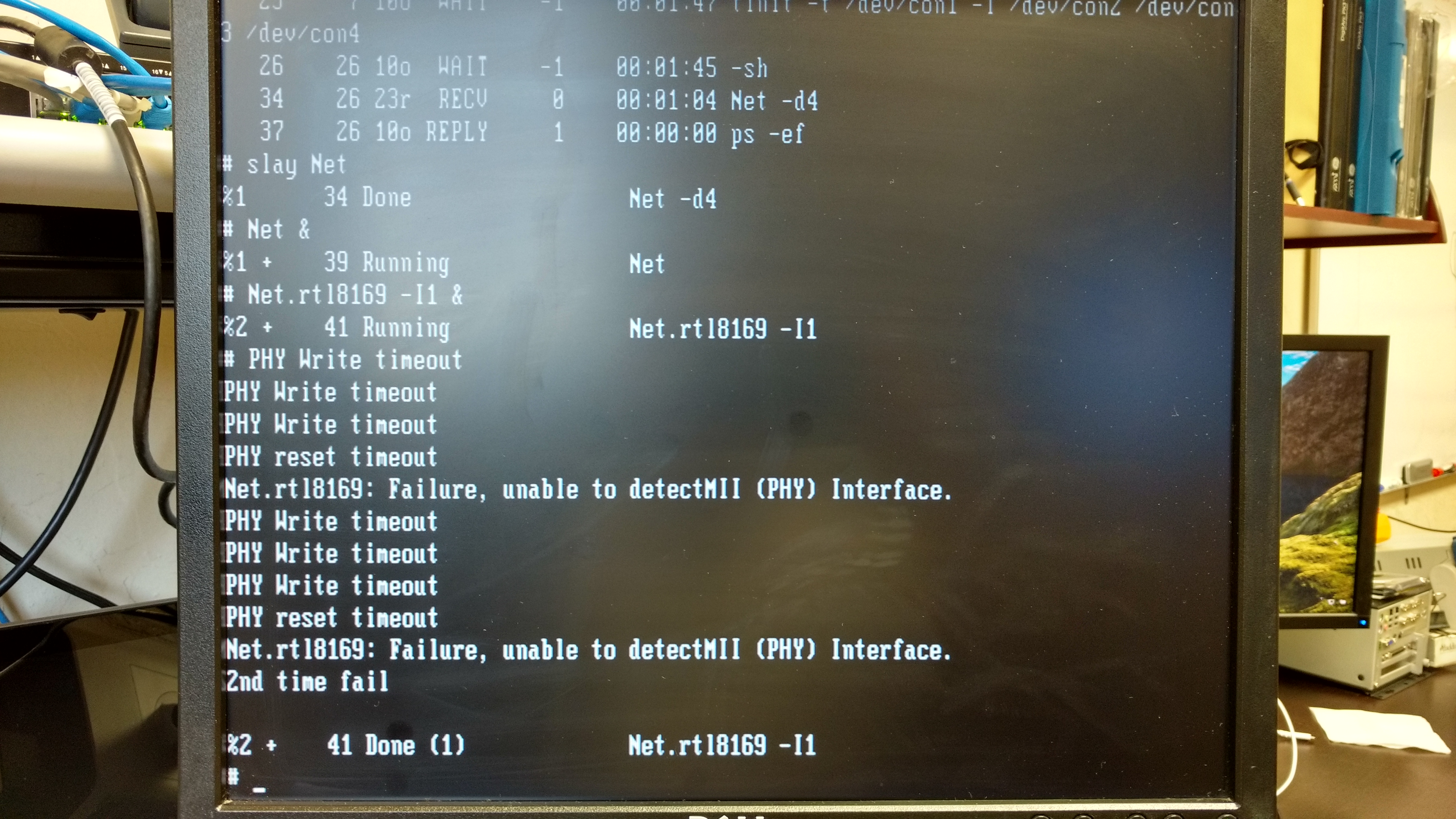

Re: realtek 8169 second ethernet port failure to init
Hello Jesus,
If you slay Net and Net.rtl8169, and then run ³Net &² followed by
³Net.rtl8169 -I1 &², does the second interface come up? It is strange that
the tcrval for the second interface is not the same as the first interface.
Thanks, Hugh.

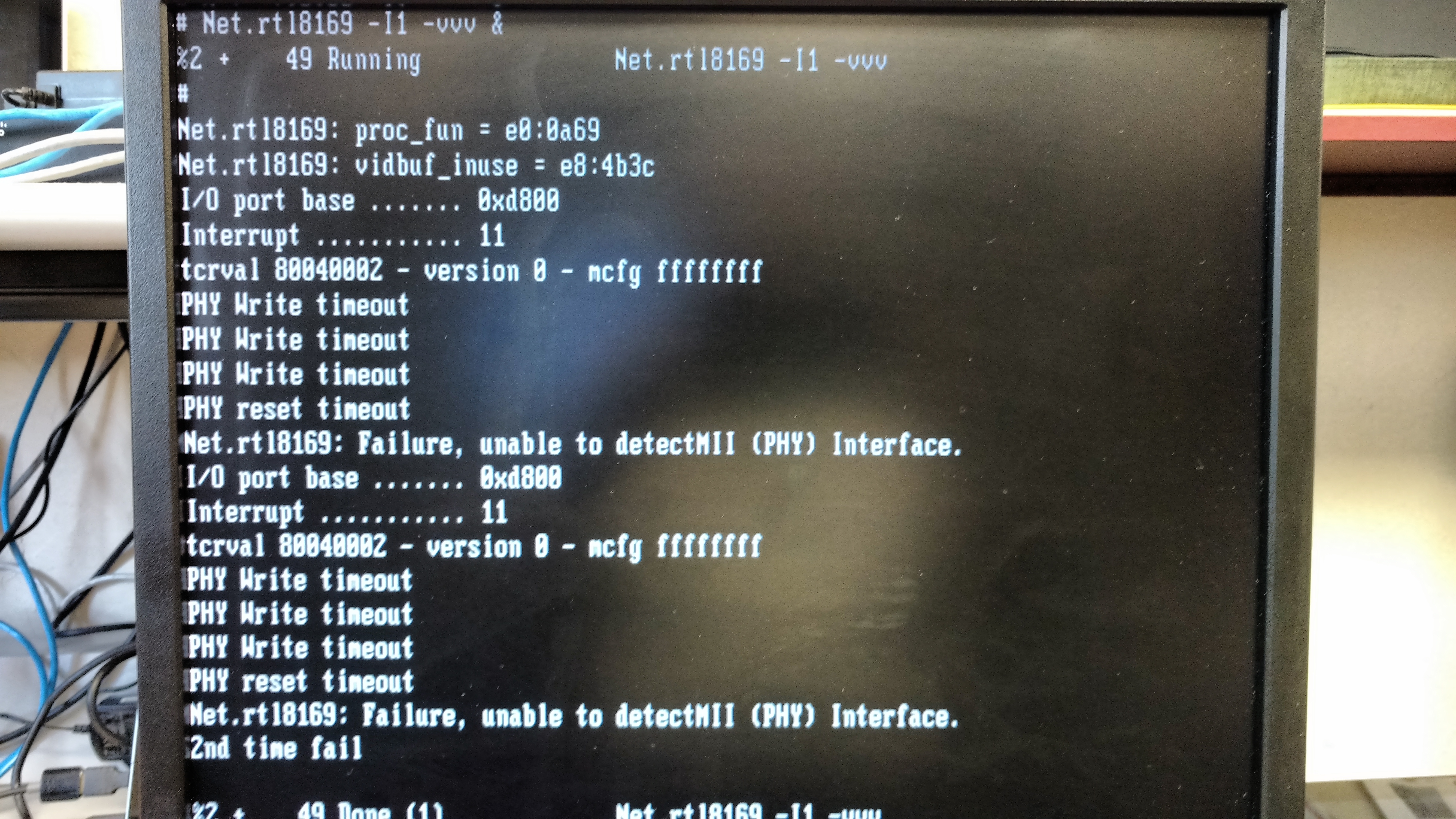

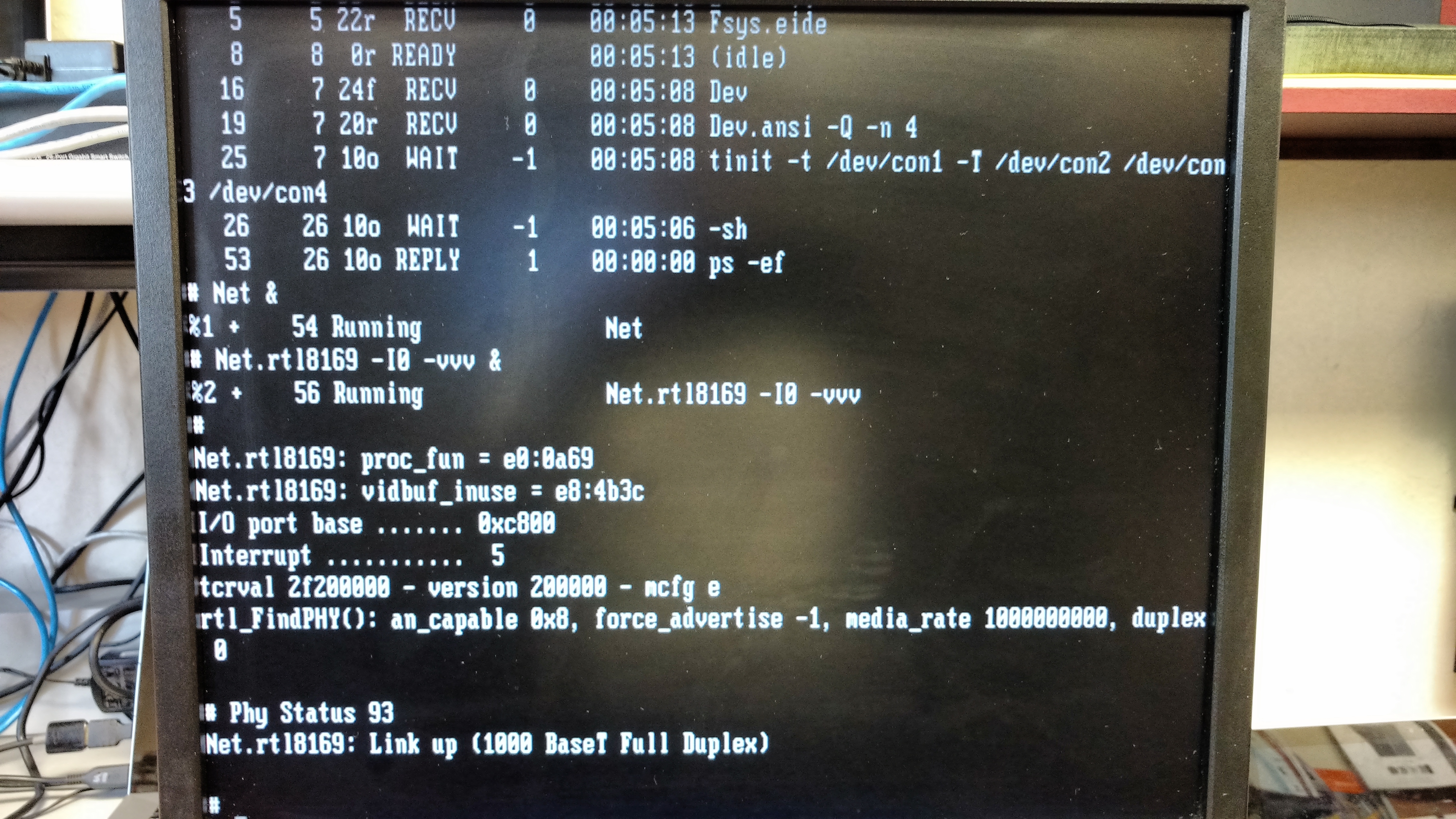

 As you asked, and I also included for -I0 so you can see the differences With -vvv
Thanks again,
Jesus Gomez
This is really weird! From the pci output that you posted, it appears that
you have 2 identical RTL8169 chips on your system, but they both give
different tcrval outputs. The one is 0x80040002 and the other is
0x2F200000. Do you have more than one of these systems? If so, do they all
give the same result?
Thanks, Hugh.
