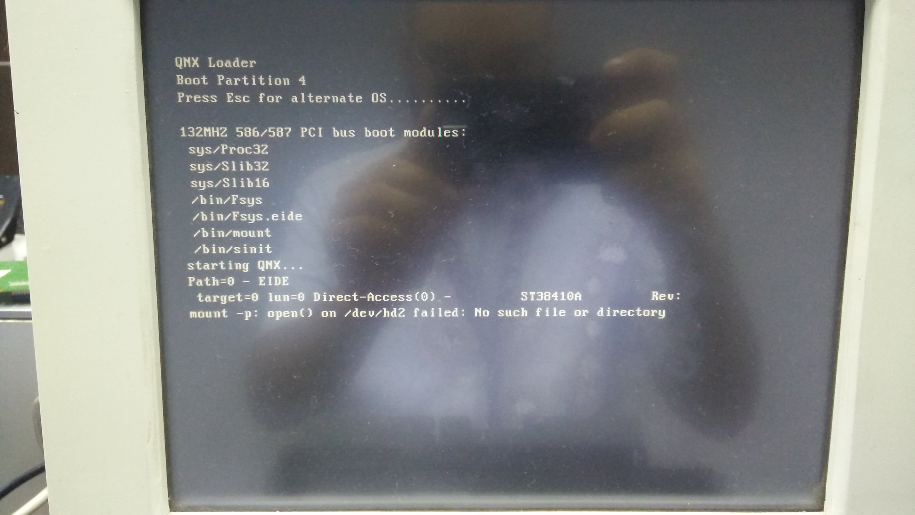

Buenas tardes, en mi trabajo tenemos una maquina llamada xiipad el cual corre una aplicación desarrollada en QNX el
cual de un día para otro dejo de funcionar, el hardware donde está instalado es un Beetle/M fabricado por Wincor
Nixdorf la aplicación está en un disco duro de 8gb, un día la pc no quiso arrancar más, indica un error cargando el
SO (imagen adjunta) se restauró el disco duro con imágenes de respaldo que se habían hecho en anteriores ocasiones
pero indica el mismo error.
Good afternoon, in my work we have a machine called xiipad which runs an application developed in QNX which from one day
 to another stops working, the hardware where it is installed is a Beetle / M manufactured by Wincor Nixdorf the
application is on a 8gb Hard disk, one day the pc did not want to boot anymore, indicates an error loading the OS
(attached image) restored the hard disk with backup images that had been made on previous occasions but indicates the
same error. Text translated by google.

According to your photo it seems that hard disk is not connected to controller anymore. Also there may were changes in
BIOS setup for the disk. Please check the disk in BIOS. Is it present in BIOS? After this check that IDE mode is set
correctly.
