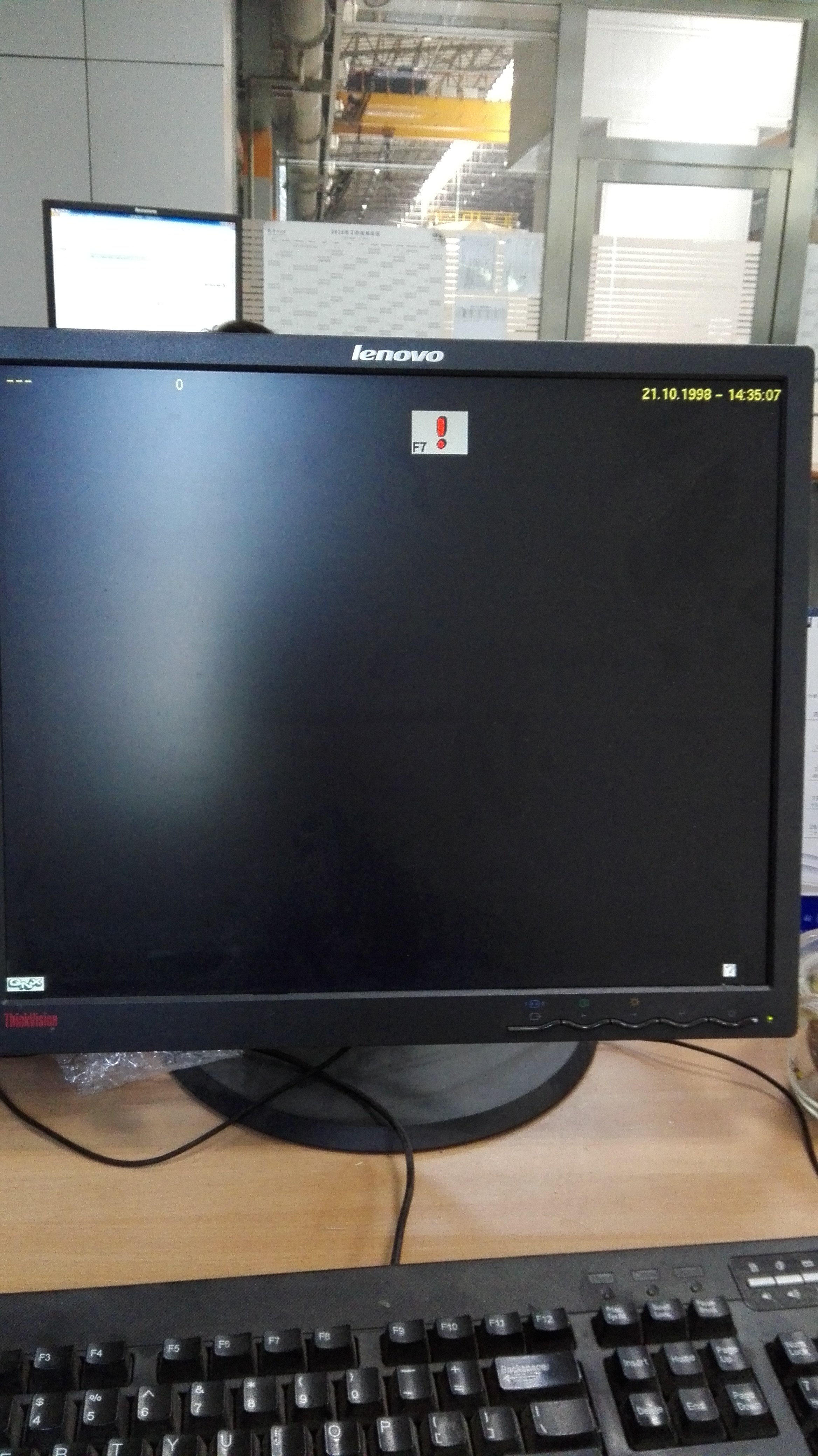

But when I start the Photon, there is problem. The graphic chip is Intel HD 3000 on the mainboard, I have tried the
latest graphic driver Pg.intelhd, but only a little part of the photon app can be display and the input does not work.
So is there anyone that can tell me what the problem is? and is the Pg.intelhd is right for Intel HD 3000 graphic
chip?

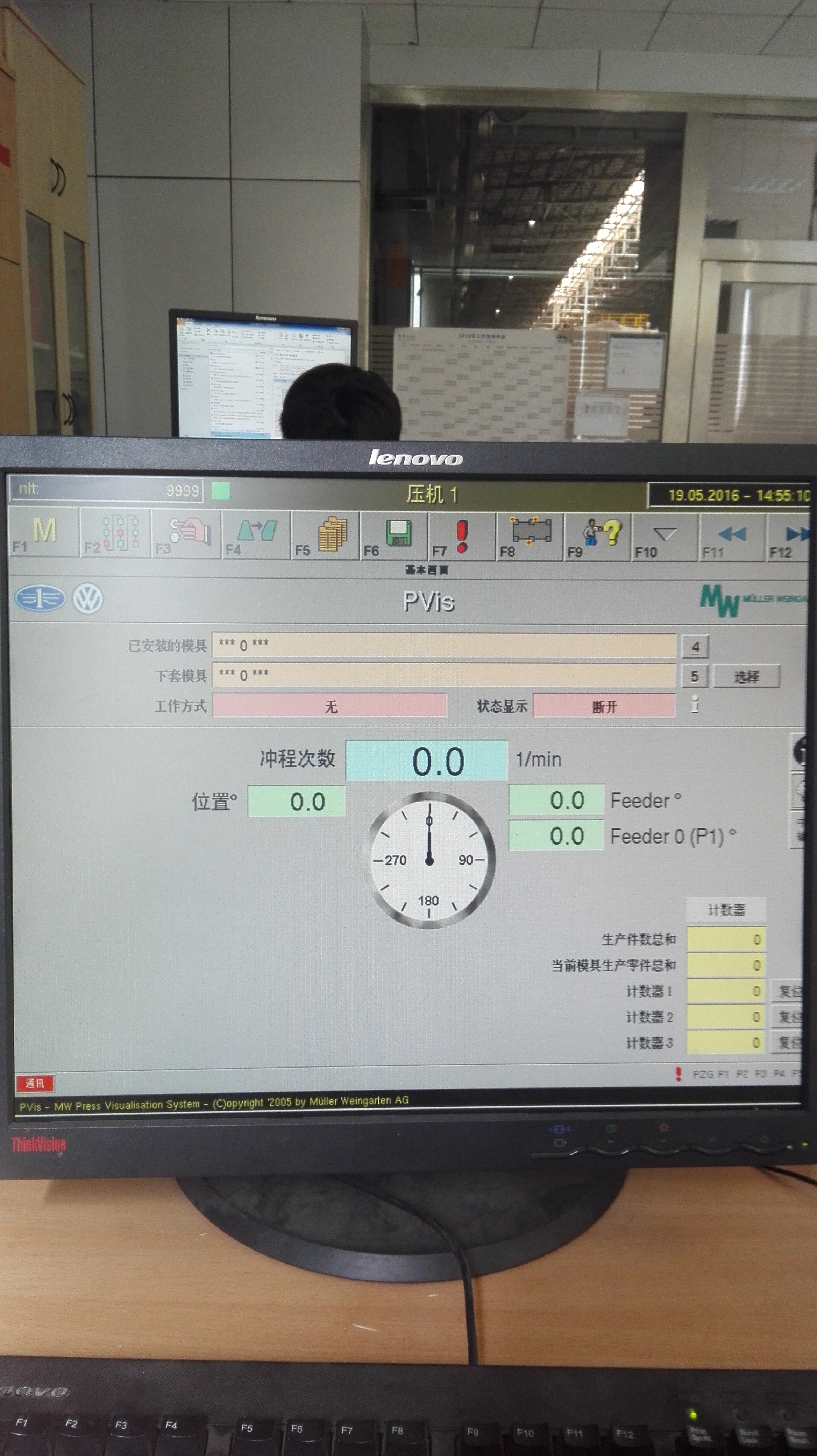

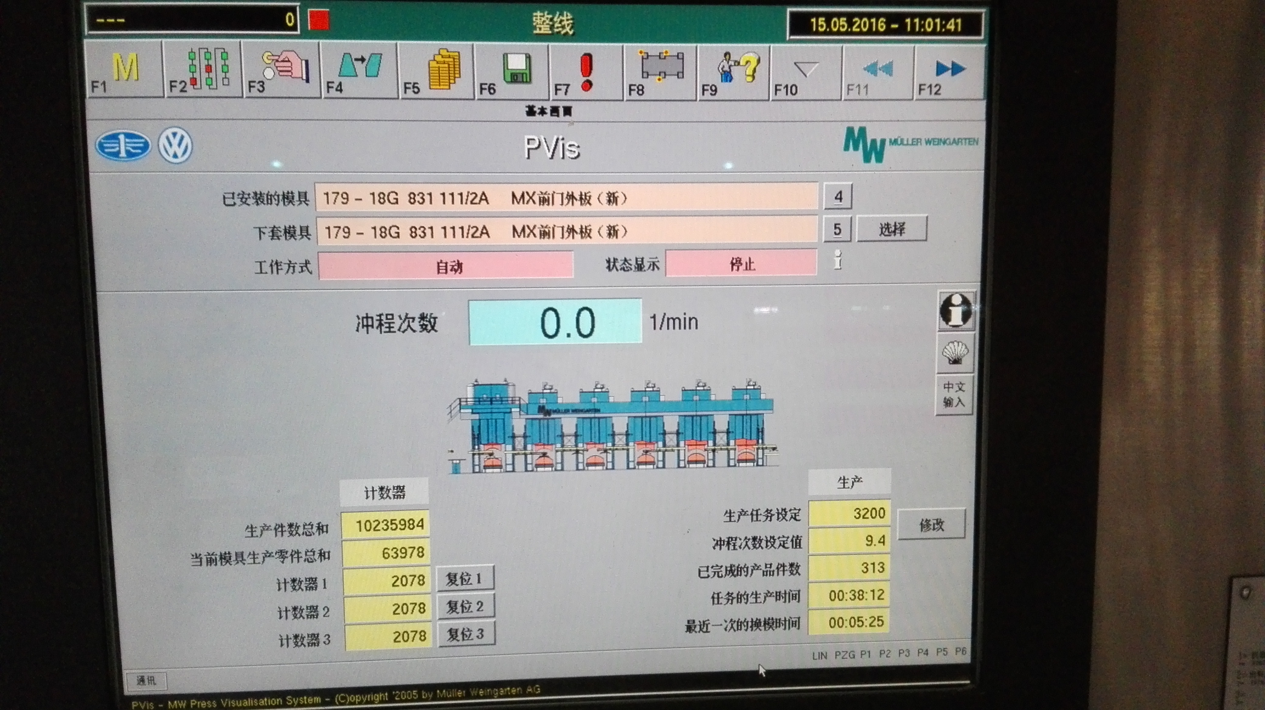

The attachment "pcivvv.txt" is the output of show_pci -vvv command. The other two attachments are pictures of
display in the old PC and display in the new one.
Best Wishes

This is may be a transferring issue. I noticed QNX button on new PC. Do you launch the same software configuration on
both system? Did you try Hydra.ms / Pg.flat* driver on new PC?

Hello Oleg,
Thank you very much. I have tried Hydra.ms -T in the traplist, and then probed the graphics, then change the driver
to Pg.flatdc32 and mode swith to Hydra.ms in crt.1, now it works.

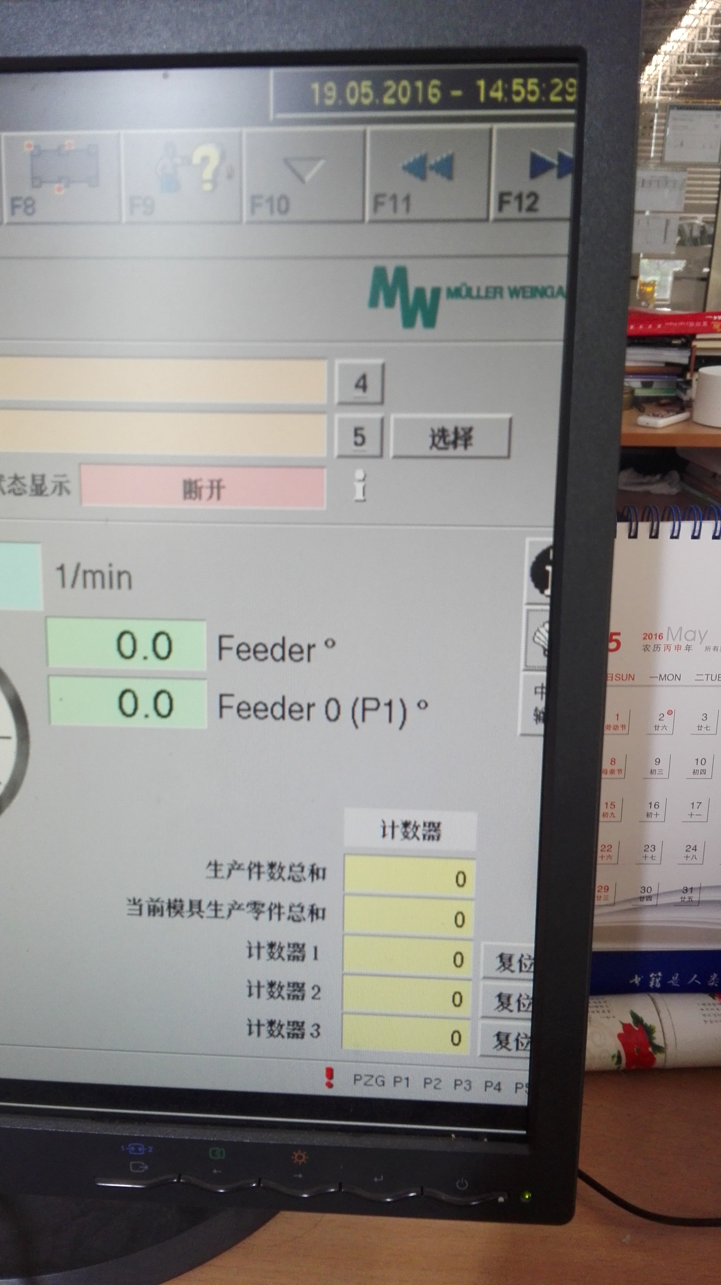

Another question, as I told you last time, I use Hydra.ms and Pg.flatdc32, it works. But there is a little problem,
a small part of the applicaiton window cannot be displayed, see the attachments. so could you tell me whats the problem
, and how to fix it?
Best Wishes
, a small part of the applicaiton window cannot be displayed, see the attachments. so could you tell me whats the
problem, and how to fix it?
The graphics controller generates frame rate that is not compatible to your monitor. Try to adjust the picture using
monitor’s menu (screen position or similar options).
