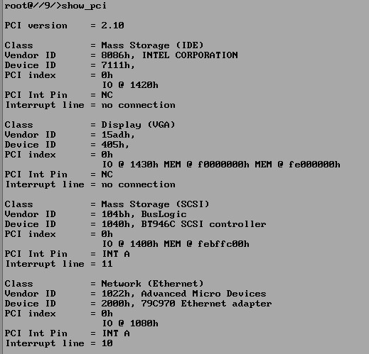

[Honey] >> We can't understand this fully. We have tried to run show_pci command. Attached file (show_pci.jpg) is the
output which we got. show_vesa command is not found in our QNX 4.25 machine.
Also we are not clear about Hydra.ms; so didn't make a trial on it. How hydra.ms can be used to access frame buffer
directly?
Could you please detail on our concerns?

As for Hydra.ms option. Look for suitable graphics mode in /etc/config/trap/crt.$NODE. Line should start with Hydra.ms.
After this you can launch Hydra.ms with all options up to semicolon sign. Don't forget to add full path to Hydra.ms. At
this point you can access framebuffer from your own application. As an example I've wrote fbtest program to illustrate
how to access to framebuffer. Note that fbtest takes all command line options as Pg.flat* driver, so you can just copy
them from your crt.$NODE file. Find attached archive with starting script (fbtest-hydra.sh), fbtest and fbtest source.
Keep in mind that fbtest-hydra.sh is configured for my HW, you should replace Hydra.ms and fbtest options with yours
from the crt.$NODE.
