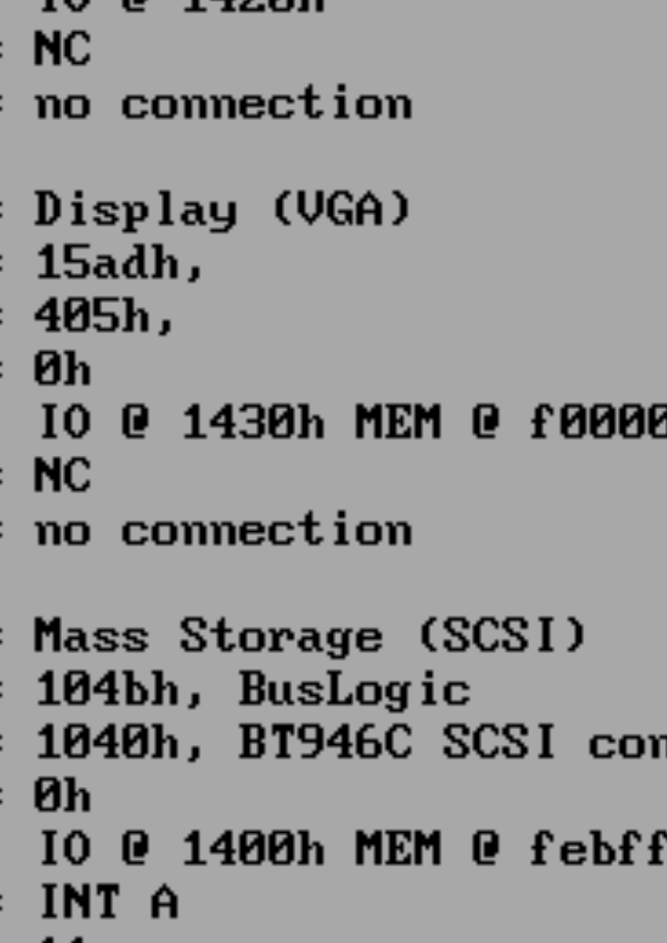

[Honey] >> We can't understand this fully. We have tried to run show_pci command. Attached file (show_pci.png) is the
output which we got. show_vesa command is not found in our QNX 4.25 machine.
