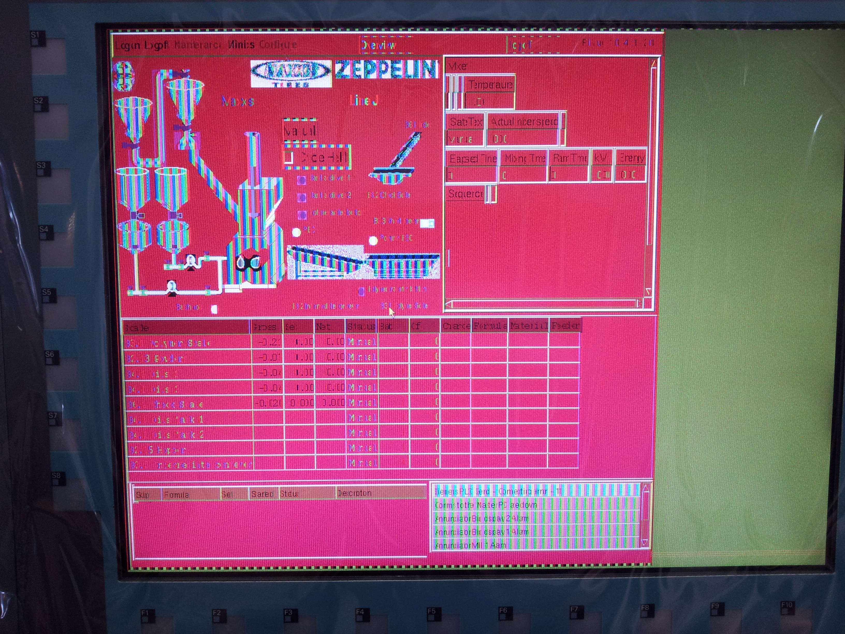

I've tried the new Pg.intelhd driver with a setting of 1024x768x32 but there is still a problem, I've attached a screen
that shows the issue.

Hello, Pete!
Is it possible that your application use different color depth?
Do you have the same issue with Pg.flatdc32 and Pg.vga4 (visually)?

I have tried Pg.flatdc32 and it works ... thank you for your help!
